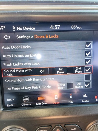

Were you able to create the same CSM on your Uconnect radio as the one I presented in post #6?
And you were able to select 'Second Press' with the touch screen but this would then revert to the off position?
Yes, and yes.

Hmmm. I made the change in ALFA to option 3, under allow horn chirp. Which then, after several key cycles, brought up the option for horn honk on lock in settings, doors and locks. And it gives me three options. one press or two presses or off.. I had the option originally for horn honk on lock. "Off" or "on". Now I have 3 options, "off" "1 press" and "2 Presses". When I select either 1 or 2 press, it allows the change, and then after a second or 2, reverts to off. With the original setting of on or off, it works properly. I will try it once again and see what happens.

Ok, I did another session with ALFA, I have 3 options in car config for horn. CBC Features; horn chirp allowed. Cust. Set. Menu 1-Sound horn with remote lock CSM present. Cust. Prog.Features-sound horn on Lock.
The CSM 1 sound horn with remote lock is where I have the option for Off, Option 2 and Option 3. Option 2 gives you off or on choices in settings on the radio. Option 3 gives you 3 choices on the radio, off, 1 press and 2 presses. I reset everything, and with option 3, I can't select anything but off. It tells me I have something set wrong, but what? Thanks for the help.

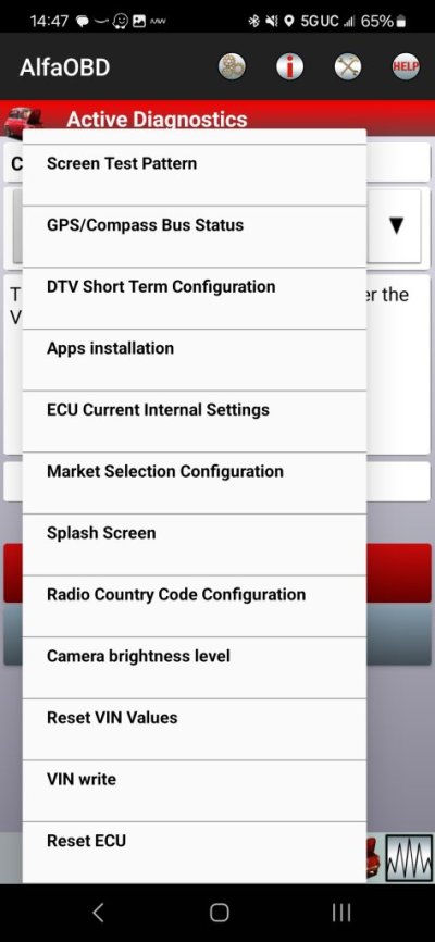

Ok, I reset everything, and here are the settings I have for horn. CSM sound horn with remote lock Feature 2 option 3, cust. prog. features; sound horn on lock: not enabled. Horn chirp allowed: yes. It will not allow me to select either 1st press or 2nd press.
Have you already reset the radio ECU?

No, I haven't. Should I?
Yeah give that a try then give it some time. It doesn't do anything drastic but you may see some weird things when it boots like an SRT logo and off-road/performance pages being installed.
