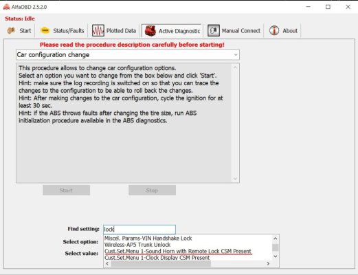

I'd like to have my horn chirp on the second lock press. I checked Alfa and there was 2 options for horn on lock, but I don't know what those options are? Any help would be appreciated.

I was able to select chirp on lock option 3, which gives me the first or second press horn, but I couldn't select either on of them, just off. I put it back where it was. Any other ideas?

I use the 14' settings. The setting was there, I just couldn't select anything but off. It would click, the checkmark would appear, then drop out, back to off. I waited a day. Several key cycles

What he is talking about is this. He can correct me if I'm wrong, but I doubt it.
He made change in AlfaOBD, But AlfaOBD "hard coded" change, cause firmware isn't fully supported, or missed an option. So now if he goes to screen and tries to make a change he can't. AlfaOBD change is overwriting the screen change.
Happens when you don't enable/select all correct the options to turn on feature and/or version of software in his truck doesn't really have it.
Sometimes upgrading software will solve it.
If @SitKneelBend made the change on his truck, he should follow the settings as Sit likely made all correct changes.
Other thing he should be able to do, is set AlfaOBD to setting he wants, but screen will not show it/be able to change it..
I would check firmware version though.

There is a setting if you connect directly to the radio with AlfaOBD that lets you reset the ECU of the radio. I have heard of this reset fixing things like this before for folks trying to add features. It pretty much forces the radio to read the BCM again to get the installed features (similar to what happens after firmware flashes). Turn the settings back on you are trying to add then Reset the ECU (be sure you are doing it for the radio, "reset ECU" is an option in lots of modules).
