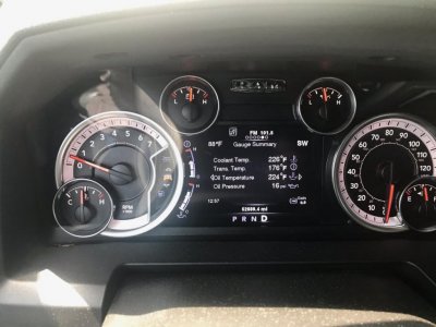

Here is a pic of mine last summer. Once snow stops, 190 thermostat, 5w30, Caulk's plug. Nicktemp ram.jpg
