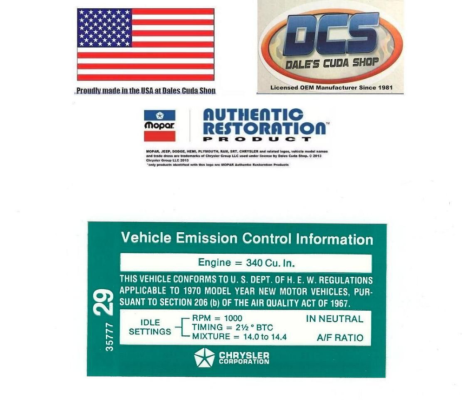

Back before they were worried about emissions,750 was a pretty standard idle rpm,and a 1,000 idle rpm wasn't uncommon on hi-po cars.Here's a tune up sticker for a 1970 AAR 340 Cuda,and it called for a 1,000 rpm.
Heres a tune up sticker for a lowly little 318 2 barrel,and it called for 750.
oh nice, well I’ll be changing my oil today then and bumping up the idle, cheers
