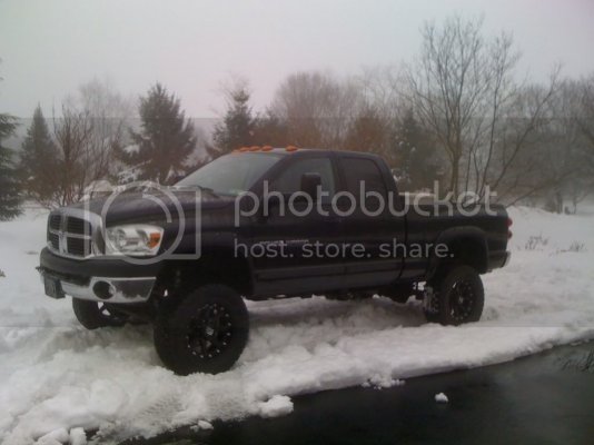

Here is a PW with 35x12.50 on stock suspension

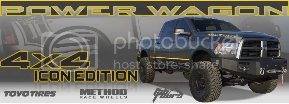

Here is one with a 4" suspension lift on the same size tire . Hell ya could even go with a 37" and be fine .

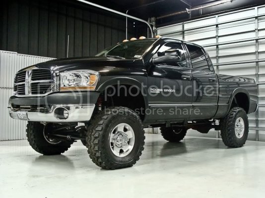

Here is one with a 4.5" with 37's to compare
And one last one ... 4" lift on 35's
0212353
Vendor
Jun 29, 2010
26,460
2,029
Florissant, MO
2x 5.7L & 6.2L
that last one looks perfect.
ramhunter9
Jun 25, 2010
24,460
983
P-Star Jeep Wrangler
Agreed and that is the setup the OP and I worked out .
