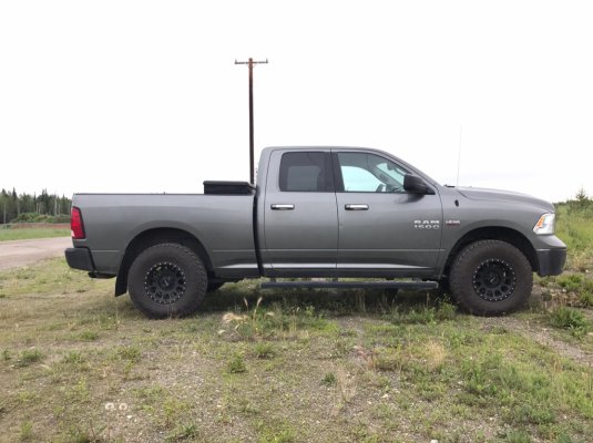

I went with 2.1 setting and a 1inch TGC spacer. Had I gone 2.8 I would have went with the 1.5 and suggest you go that route. That way you can load the back and know you can sit level with a decent load in the back. I'm gonna be picking up a half cord in the next week or so and will try and snap a pick
Here is mine with Bils and TGC installed 23a94475831fb61ccbf12afca212aebe.jpg
Sent via telepathy

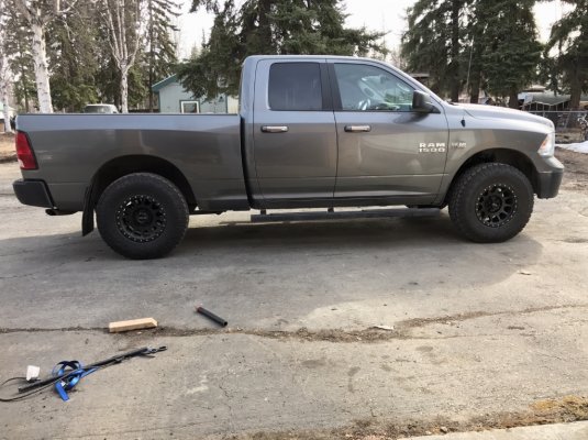

Sorry this took so damn long! Busy week so far. Bils at 2.1 and TGC 1" spacer with 34x11.50 Toyo AT2 extremes
Sent via telepathy

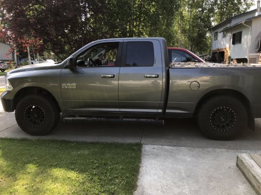

Finally got a chance to get the wood moved. About a 1/2 cord of white birch
Sat pretty squat but not too nose high. Handled great and could hardly tell I had exceeded the payload except over big frost heaves where it liked to keep bouncing a bit longer lol
Sent via telepathy
