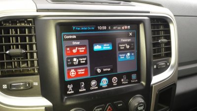

I have a question. If I do this mod and do the programming (via either OBDII Genie or AE Tool) will that "Controls" screen be added to my RA4? I do not currently have that screen on my radio.
Yes the controls screen would come up on the radio with the appropriate soft keys for the wheel and the seats.

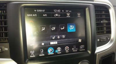

Yes it will come up on your screen as well as the controll button on your RA4. You may as well add the auto dim rear view mirror function at the same time. I have a 16 radio so I can switch my icons around on my options bar that's why it's not showing in this picture but it's there.
I found another picture that shows the control button after I changed it.
