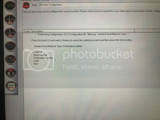

Which material choice gives you the best result?
I didn't test them all. I set it to perforated leather as that is what the seats have and it made a big difference on how fast they get warm and how warm they feel. I actually turned them off driving home as they felt pretty warm. I had used them previously this week and they never really felt that hot.

Did you turn on any of the options in ECU 5? I noticed yesterday when I was looking that heated seats and/or wheel were turned on in there (I don't remember if it had both or just one) even though I don't remember doing it and didn't put it in my notes. It's possible that it is the reason why I have the comfort options in my RA4 and you don't, so I would enable any features that are in there that you have installed. I can't see how that would hurt.

The setting is in the BCM, so we're SOL unless there's a software update for the BCM that adds it. I doubt that's the case unless there is also an update to the CSWM so it knows to use it.
