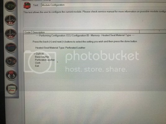

The other thing that I changed in ECU #5 was the heated seat material. It was set to "default", and I could choose from Standard Leather, perforated leather, or cloth. I set it to perforated leather. It really made a difference in how fast the seat's leather heats up compared to the default setting.
If the OBD boys want to do this right they should be asking what kind of material is on the seat and setting it appropriately.
I flipped the ventilated seats on for a minute on my way home and couldn't believe how cool the air coming from them was. It definitely will be nice in the summer.

I was surprised how cold the seats got too. I always kind of thought they were a gimmik and wasn't expecting much. It's obviously cold outside so that makes a difference but they do work. I am going to go into ECU# 5 and see what fabric my seats are set to. I never thought to even go look.
I'm curious to see if yours has that parameter,Rick. I know for a fact that mine doesn't.
Did you turn on any of the options in ECU 5? I noticed yesterday when I was looking that heated seats and/or wheel were turned on in there (I don't remember if it had both or just one) even though I don't remember doing it and didn't put it in my notes. It's possible that it is the reason why I have the comfort options in my RA4 and you don't, so I would enable any features that are in there that you have installed. I can't see how that would hurt.

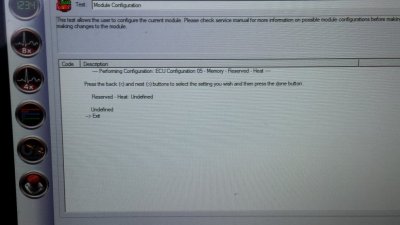

I found this reserved heat setting that may be what he found. It says unidentified but there are no options to change it.

Your truck is identical to mine, Rick. If you haven't already, I'd flip on that heated wheel setting in ECU 5 as I have that on. Maybe that'll get you your auto-on setting.
