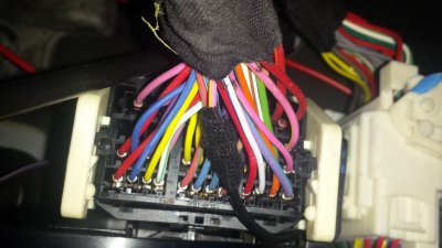

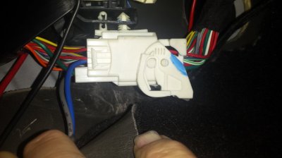

Okay I know I'm not good and posting pics with descriptions. Now that's wrapped up I wanted to show exactly were to tap in at. This is the plug you will tap into for the heated wheel. This plug is under the dash moutrd to a plastic tab.The wires for the heated wheel enter from the right side of this plug but our trucks do not have the correct harness so we don't have the correct wires coming into the left side of the plug for the heated wheel. I installed the correct male pins on two wires a gray wire and a blue wire is what I used and insert them into the left side of the plug. The two wires going into the right side of the plug for the heated wheel are pin#7 gray/light blue and pin#15 dark blue and light green.

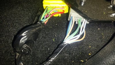

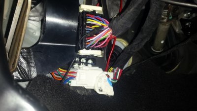

This is a picture of where you will tap into for the trigger wire for the relay for the two wires that attach to the two pink and yellow wires in the yellow drivers side seat plug. This power sorce can only come on when the key is in the run position. Just like the heated wheel our trucks do not have the correct Guage ignition on run wire coming into the cab so we need to install a relay. You can see the pink and yellow wire I tapped into with a black wire to run to the relay I installed under the drivers side seat. Use a mutimeter to make sure you have tapped into the correct wire and it only has power with the key in the full run position. This picture rotated on me again when I posted it. This plug is actually strait up and down not horizontal . It is directly over the plug you will install the heated wheel wires into. I posed a,second pic to show the correct orientation.
