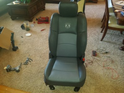

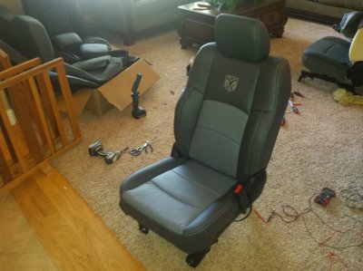

Yes. I bought custom covers from leatherseats.com and did it myself. It wasn't too bad. I was pretty impressed with their product. I have never done upholstery before but they fit absolutely perfect. And no the wife wasn't really happy I decided to upholster them in the house!

I got mine from Seats and Such, way back. I only bought the front seats since I have a regular cab. A big issue for me because I have the floor shifted transfer case, I can only have the jumpseat console. Finding a black Laramie or sport jumpseat is very difficult, so I wound up having to recover mine with aftermarket leather.

Ricks Ram they look great! Looks very professional!

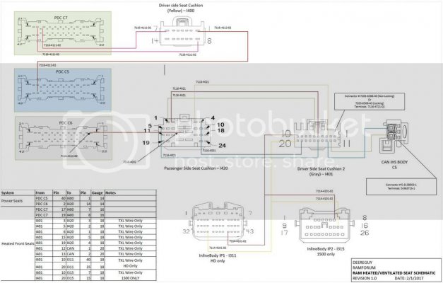

I've been working on putting a schematic together that incorporates Rick's and 00R/T's work and the research that I have done into the same format that cptwing and mpgrimm2 has done for the RA4 conversion. Here is my first draft. I'll keep making updates to it over the next several days.
FYI, I updated the schematic today to show all of the correct terminal numbers as well as added a connection matrix. I'm still working out all of the back seat wiring, but I'll get it added soon also.
**Note: The wiring color does not reflect actual factory wiring colors. I just used different colors to delineate the different wires on the schematic.
Looking great bud! :happy107::happy107:

Thanks. They have been on for almost two years and seem to be holding up well. They are not to bad to install if you take your time. There are several videos on You Tube that can walk you through it. Tim at Leatherseats.com was very helpful with any questions I had. I decided to do in myself because the prices quoted to me to install them were ridiculous. One place wanted almost 1000.00 the best price I was around 600.00 if I brought the seats to them and they seemed kind of shady. They said it was so high because aftermarket seat covers do not fit as well as factory and it took a lot of work to remove the wrinkles. I bought a 30.00 garment steamer from Walmart and I experienced no fitment issues at all. Once I got the hang of it and how to attach the hog rings it was actually kind of fun to do.
Very nice this will help a lot of folks I'm sure, but don't be surprised if your work gets "plagiarized" and used to make money with.
