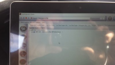

Do you have any DTCs persisting in your CSWM? Just curious.
I only had one code when I checked. It was for interior CAN performance. Not sure if it's anything that will clear up. I am going to go back in and check again later and see if it's back.

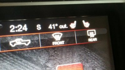

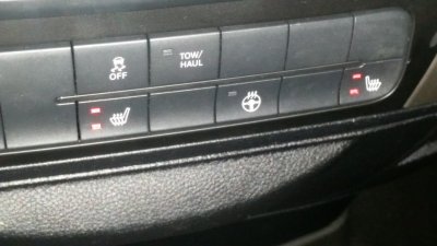

Heated seat success! A HUGE thank you to both RicksRam and DeereGuy!!!! It took a group effort...as this is way way over my head and skill level....... but very happy to report that my 2016 Express, with 2016 Big Horn front seats.... now has heated seats!!!!
I also ran the wiring for the heated wheel, but have not yet swapped out the clock spring, will report back when I get to that.

DeereGuy
Nov 9, 2016
623
589
Pittsburgh, PA
Whohoo!!!!

I can also report that the truck is correctly registering the temperature and controlling the seats and wheel correspondingly. It was 45 here today and the truck did not kick either on automatically.
Mine works great too. I am curious to see if the Ventilated Seats turn on automatically when the weather gets hotter. I am assuming they should work correctly as well.
