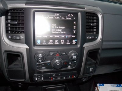

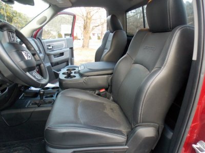

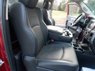

Well I got the seats in earlier today but did not get to the clock spring yet. All went well and as expected, well sort of.
No wires to run, just installed them.
All power functions worked.
Heated elements in both seats worked.
No cooling either seat yet.
And of course no heated steering wheel yet.
But I have the air bag message and light on. These seats are definitely 13 and up seller claimed they were from a 14. I am hoping it is jus a DTC I can clear, but I do not see any SRS labels on the seats. Anyone else have an issue and where is the SRS label on Laramie seats.

The SRS label is on the seam between the side panel and the outboard bolster. If they have the "Laramie" logo embossed instead of the Ram's head, then they're 13+.
Did you buy them from Seats & Such by chance? He sometimes sells 5500 seats without airbags. I have a feeling that's what you have.
You can check for the airbag wiring in the plug under the seat. You can also unzip the seat at the back edge and visually check inside for the airbag. It's a large black plastic assembly inside of a nylon pouch.

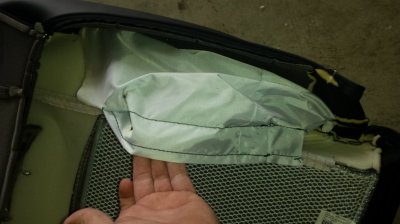

It is not hard to install the airbags from your old seats to your new seats. I have done this. You may not have the tab that says SRS but the airbags can be installed. Your seats will not have the nylon(intensifier sleeve) as shown in this picture that has the air bag style seat covers
but you can still install them and have no codes.

While it would solve the issue of the codes being set, I wouldn't want to be sitting next to an airbag that's missing the system that directs the deployment energy in a safe direction. There's really no telling what's going to happen if that bag deploys inside a seat not designed for it. I think disabling them entirely would be safer than that.

Didn't think about that.... good point. Unless you are going to install new seat covers that had the correct sleeve for the airbag intensifier RT is right I would probably try to disable it.

That nylon bag doesn't direct anything it holds the module in seat cavity!
This came straight from my leather shop that's done 100s of katskinz but the zipper is designed to blow out on deploy its thread is different
