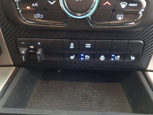

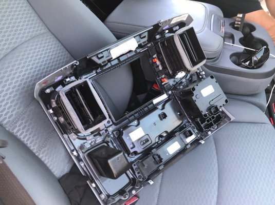

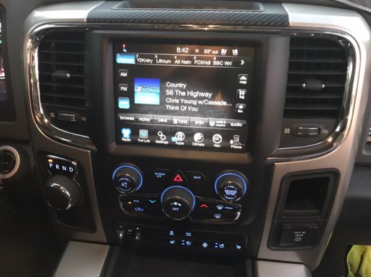

Just an update of where I am with my seats & 8.4 conversion. I've got the seat codes added with the AE tool. I didn't mess with any of the other codes because of the issues with corruption. My conversion is up & working with 2 minor exceptions. I got the wrong Hvac controller. So when I get to the 7 speed it turns off. I have the correct Hvac controller on the way now. I also have my passenger seat heat that won't stay on. It shuts off after just a second. We've had a few people with strange issues with seats & the 8.4 conversion. Usually coming down to some part not being correct. My cooling works just fine in both seats. Anyway I am hoping when I swap my hvac controller. It may just start working again. I don't plan to waste to much time on it at this point. With summer & warm weather here. I really wouldn't be using it for 4-5 months anyway. I've put off getting the Hvac controller long enough. Really wasn't a huge issue that the 7th speed didn't work. Finally took the plunge hoping it may get my passenger seat working.
My passenger seat was working with the hard buttons before I did the 8.4 conversion

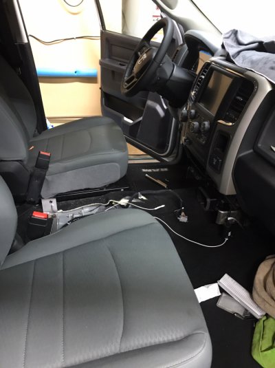

Finally got my seats into my Tradesmen and it works great. Mike and Mike over at M2 Mods made an awesome harness and I found some seats at a wreaking yard. Rick helped me pin them and throw them in. We fired up the truck and the heated and cooled seats worked with the buttons without programming. So nice going from the cloth manual to the electric heated and cooled. fdd04c52b7466421027e94ff4330e524.jpgac884c419dd7c14f929ebe4c21731771.jpg19f385e2d94242ff5c13cfc521305584.jpg

To the best of my knowledge these are the only seats besides mine that worked before we even added the codes. These seats where out of a 14 Sport and we installed them in a 15 Tradesman. My seats where out if a 14 Laramie and I installed them in my 14 Express. So far it seems like the 14 seats may be a little more compatible for the conversion but there haven't been enough installed yet to say for sure. As STecoD stated as usual M2Mods built him a beautiful harness.

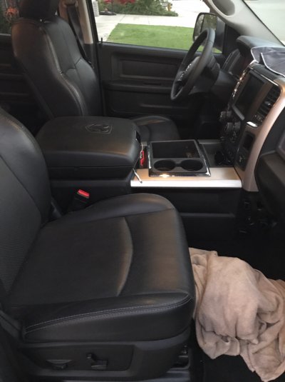

Rick, my friend helped wire up my 14 laremie seats into my 14 express last night. Once it was all wired and plugged up the power works on both seats and the heater for the driver but the heater on passenger does not( it will illuminate and then turn right off). And the cooled seats don't work for either side. Any help or suggestions is greatly appreciated. All of the wires have continuity. ��

The first thing I would recomend is to check your wiring from the passenger side seat to the drivers side gray seat plug. You can have just one wire off and it will not function properly it kind of sounds like that's what you have going on. Those are the pins 1 through 5 from your passenger side seat. There are schematics and diagrams in the beginning of this post that will help you verify you have them in the right place check that and let us know what happens. The 14 seats seem to be pretty successful for the mod so I really think your problem is somewhere in your wiring.
