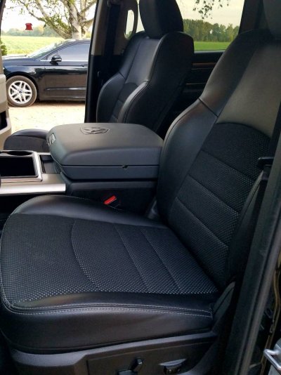

apatalk-cdn.com/20170810/1e15d0f0f8a5f4e7aebfbc960aa316be.jpg[/IMG]View attachment 90907

Very nice!
Sent from my SCH-I545 using Tapatalk
Those look like the ones I went to look at in Greenwood, SC today but someone beat me to it
