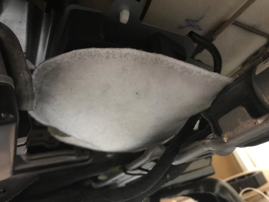

STecoD
Apr 2, 2017
162
175
NorCal
2015 Crew Cab Tradesman
3.0L Diesel
If you look under your seats you will see what looks like a computer fan on top of a bag. I have sport seats in mine and they are vented. e628e8fbdb3adc091bf9ec1a2d166af9.jpg

Arent the heated seats a solid leather panel, the ventilated perforated.
