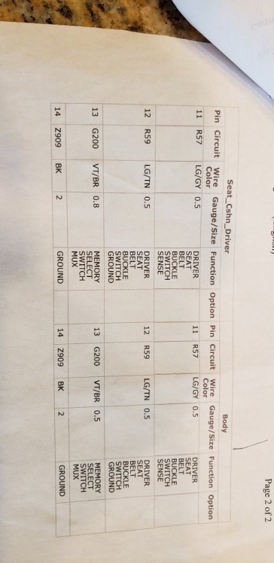

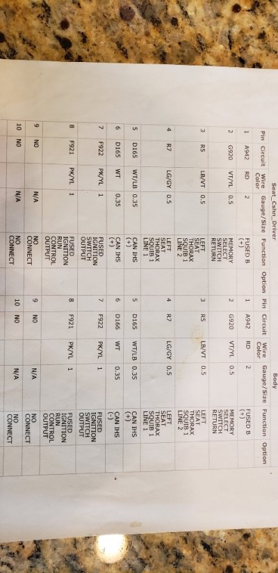

Thanks for the response.
Is there a way I can get a look at the 13-18 pinout diagram your referring to? Cant seem to locate the correct one online.
Ricks Ram
Ricks Ram
May 1, 2015
4,411
3,388
Passenger seat yellow connector.fc65b9a9c9de4c2c6c39fe5f1cff0a95.jpgc486f134a636c7378a5ec3100756f201.jpg
Sent from my SM-G981U1 using Tapatalk

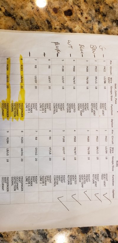

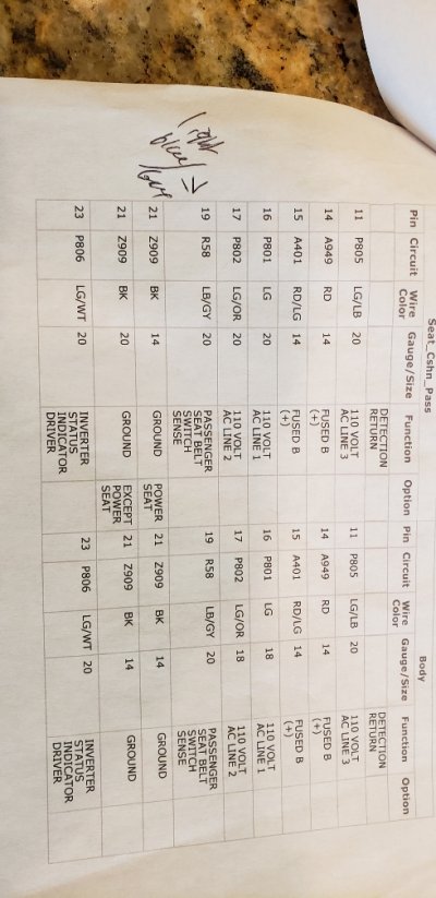

Ricks Ram
Ricks Ram
May 1, 2015
4,411
3,388
Driver's seat yellow connector. Please disregard my notes in the pictures. I used these to build my original harness.553bd01a2ce2ec4d0af97bd12fde711a.jpgf52f1241a28a03940c22071950f64705.jpg
