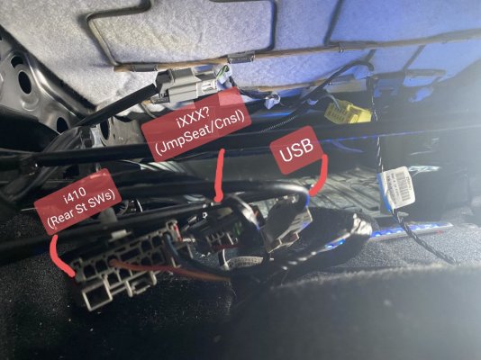

Could you possibly post a picture of the bottom of the seat? There should be several connectors that are disconnected where the MSM should go. You can contact Benny @AllMoparParts.com in the vendor section of the forum to order a new MSM. Hopefully they disconnected the module and didn't just cut it out. One other question is are you sure the seats are out of a Laramie? If so you should have the memory button on the side next to the lumbar switch. The sport seats look almost identical to the Laramie and don't have memory. I have only seen the modules removed one other time before before the seats were sold and those were from a wrecking yard. It's very uncommon for the modules to be removed. Lastly, I can't see the year of your truck on Tapatalk but I'm assuming it's a 13 to 18/Classic. You will need seats from a 13+ Ram. The driver's seat should have one yellow connector and one 20 pin grey connector if it's from a 13+ truck. 4d82205719e195e9a2dfd18b5529171a.jpg

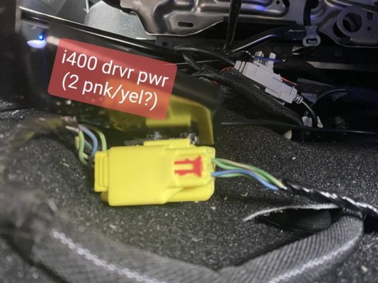

If your truck has two pink wires with yellow stripes going to the drivers seat yellow seat connector (i400) your truck is pre wired. If it doesn't have those two wires it's not. It's that simple.

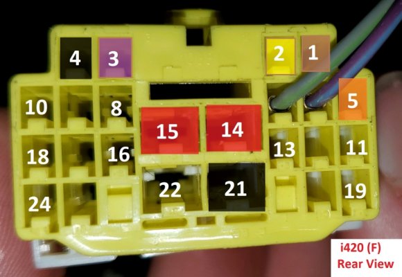

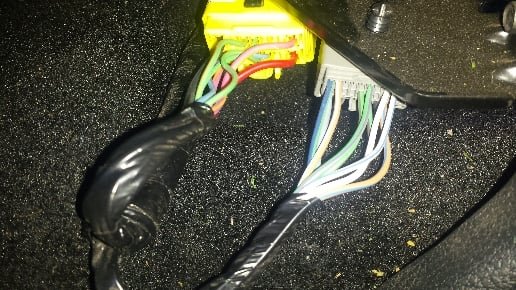

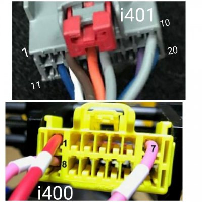

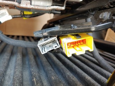

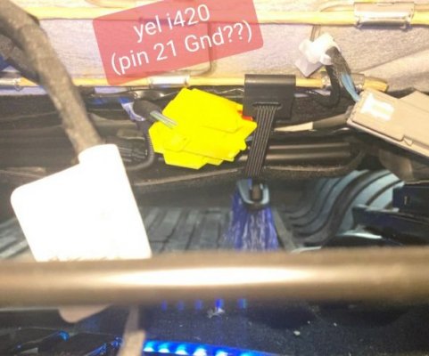

Correct me if I'm wrong since you & STecoD have actually put hands on more of these then just about anyone ...
He doesn't have the wiring to support heated/cooled seats?
- I don't see the matching grey, i401 (20 pin) plug for heated cooled seats coming out of the floor on the driver side (just the yellow i400 and grey i410).
- I don't see the ground wire at i420 pin 21 (yel) passenger side plug.
Driver side
Passenger side
M² Mods.
It would appear he does Not.
I always just tell everyone to look for the two pink wires with yellow stripes in the driver's seat yellow connector.
If you have that wiring then you at least have the wiring for the heated/vented seats and heated wheel. I tell people to just look for those two wires because it's quick and easy to check and in some cases I have seen the trucks had the 20 pin connector but it was shoved under the carpet for some reason and guys didn't think they had it. You will most likely not have the 4 extra wires for memory seats and mirrors or the 7 extra wires for memory pedals if you want them even if your truck came with the heated/vented seats and heated wheel wiring but obviouslyyou can add that wiring if wanted.
This is a pic of the MINIMUM wiring needed for Non Memory Heated/Vented Seats and Heated Wheel. You can see the two pink wires with yellow stripe in the yellow seat connector if it has that it will also have the 20 pin gray connector that's shown in this picture but it's sometimes under the carpet.

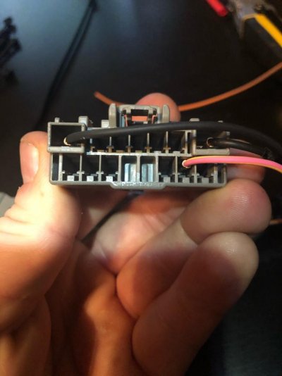

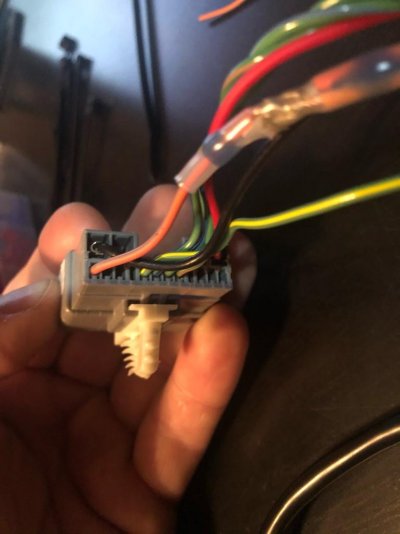

I will be replacing my front driver manual seat with a powered seat (no heat, no cooling, no memory). The connector under the seat on my SLT apparently does NOT have the 12v power that is needed. What is the recommended gauge wire if I want to run the power from the battery to the connector under the seat? Do I also need to run ground wire? Any ideas on good location/method for getting through the firewall?
Thanks
Mpgrimm2
Supporting Vendor Navy Badge
Mar 30, 2014
6,588
5,202
SC
2022 Ram 1500 (5th Gen)
5.7L
14 awg wire. Go though the clutch plate blank.

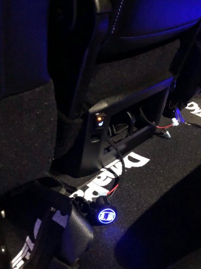

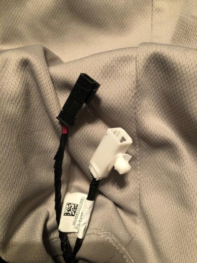

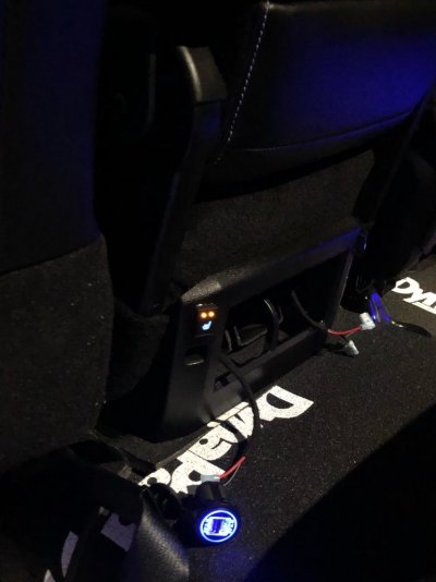

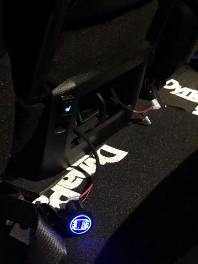

Installed Parts:
2015 Laramie Longhorn Driver/Passenger Seats (memory/heated/vented)
2015 Laramie Longhorn 60/40 Rear Seats (heated)
New Heated Seat Module - 68217268AF
New Heated Clock Spring - 68110740AE
New Heated Steering Wheel - 5NH65DX9AA
New Rear Right Heated Seat Switch - 68059873AC
New Rear Left Heated Seat Switch - 68059874AC
New *Partial Console Harness - 68398181AA
New Inverter Dash Plug
M2Mods Wiring Harnesses
*Disseceted out the rear seat button portion of the console harness and merged it with my jumpseat harness.
AlfaOBD Settings "Enabled/Yes"
Cabin.Net - MSM Memory Seat Module
Cust.Set.Menu 1: Auto-on Driver Comfort CSM
(Option 2-3)
Cust.Set.Menu 1: Easy Exit Seat CSM
Cust.Set.Menu 2: RKE Linked to Memory CSM
ECUConfig 3: Front Vented Seats Present

Good evening all!
2019 Ram 1500 Express Classic
OEM 8.4 4c UAS Radio (w/ carplay/Android auto)
Customtronix Enzo Jailbreak for front camera
40/20/40 Front (jumpseat) Cloth/Manual
Bench Rear Cloth
Installed Parts:
(Option 2-3)
ECUConfig 3: Front Heated Seats Present
ECUConfig 3: Heated Steering Wheel Present
ECUConfig 3: Memory CSO Present
ECUConfig 4: Heated Seats Present
Memory: Rear Heated Seat Present
Memory: Front Vented Seats Present
Memory: Heated Steering Wheel Present
Memory: Heated Wheel Material - Leather
Memory: Seat Material - Perforated Leather
Memory: Memory Seat Present
**Couldn't find Cabin Net: Heated Seat Module Initialize**
Currently have everything installed for a test fit/test function.
Working properly:
Driver/Passenger Seat power functions
Inverter Plug
Left/Right Rear Heated Seat Switches
Left/Right Rear Heated Seat Heating Elements
Not working:
Heated Steering Wheel shows in radio under controls. When pressed, turns on for ~5sec then turns off.
Heated/vented seat icons MIA in radio.
-have double-checked Alfa
-have cycled radio
-have given radio days to take changes
-have pulled fuse to hard reset radio
I wasn't able to find the HSM initialize command in Alfa and am wondering if that might help the HSM and radio communicate.
I can connect to both MSM and HSM through alfaobd.
In the MSM I have a code B1D98. I ran a system check and the seat moved, but test stated failed.
In the HSM I had a code U1446. I was able to function the vents on high and low correctly as well as heat, but the test ends before you can really feel any heat in the seat.
I am NOT using the hard button panel, due to having the 5 aux buttons populating the bottom row. Unfortunately can not check functionality there.

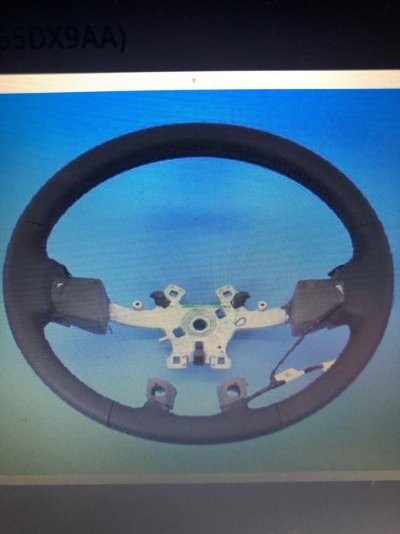

My new heated steering wheel came with 2 connectors, one white, one black. The white one connects to the clockspring, the small, 2pin, black connector doesn't have a home. I'm using the wheel harness that came with my express steering wheel, do I need to purchase/install a specific heated wheel harness?
Yes, the heated steering wheel takes a separate harness than the regular steering wheel. There should be no connectors left unused for the heated steering wheel. As far as the heated/vented seats not showing up on the radio I don't have any answers for that as long as you have all the options enabled which it appears you do. I used a UAQ for a short time and my mirror dim plus one other feature that I can't remember at the moment would not show up in my Apps screen. The UAS/UAQ radios are a little glitchey. As far as the memory feature goes I have had several including my truck fail the memory test feature with the Alfa tool but the memory feature as well as the easy exit seat still works. Did you actually test the memory seats to see if they work? I'm assuming the harness you bought from Mike had the feature built into it. The first thing I would recommend doing is contacting Benny @AllMoparParts.com in the vendor section of the forum and ordering the correct steering wheel harness. This should correct the heated wheel issue. As far as your radio not showing the soft keys maybe someone with more experience with the UAS/UAQ radios will chime in. I wasn't a big fan of it and put my RA4 back in so I don't have a lot of experience with them. Possibly changing to a different firmware or finding another radio you can test would be an option.
