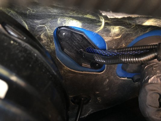

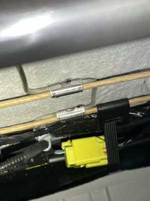

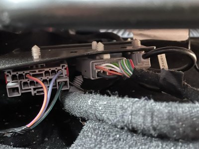

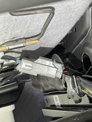

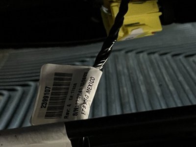

I have a 2020 1500 Express crew cab with black cloth manual bench seats. I have a line on some power, heated and ventilated leather seats and was hoping someone could tell me if my truck is wired for them or if I need to get a harness. My biggest concern is ensuring the drivers side is operation right away, at least the power adjust, as the truck is my daily driver. I can do the heating and ventilation down the road. I have attached some pictures of what wiring is under my seats.

These are the other pictures.
It doesn't look like you have the required wiring, but to get power adjustments you'd only have to run 1 wire so it wouldn't be too bad as a temporary solution

You 100% don't have the wiring for heated/vented seats or power seats. You can purchase a conversion harness at M2mods in the vendor section of the forum. It is plug and play and installs exactly the same as the factory harness. You would also need to purchase the Alfa tool to enable the codes for the heated/vented seats and heated wheel to work. The dealer cannot enable these codes. You can make the power adjust work by running a fused wire from the positive battery post to the solid red wire in both yellow seat connectors if that's all you want to work.
Sent from my SM-G981U1 using Tapatalk
How hard is it to run that fused line? I have never done anything like this before and was hoping it would all be plug and play. But your never too old to learn a new trick or two.

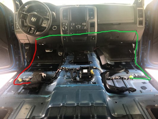

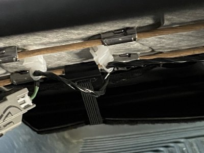

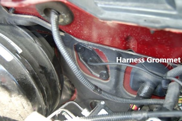

Not too difficult at all.
-Run you power wire with ring terminal and in-line fuse from the positive battery post back to the firewall. (tuck out of the way/follow OEM wiring harness where possible)
-There are 2 common points of entry into the cab. You can drill a hole into the clutch delete plate. The hole can be sealed with a rubber grommet or silicone. Or you can cut a slit in the rubber grommet of the main OEM wiring harness entering the cab on the driver's side and fish the wire through the boot, sealing with silicone.
-Once the wire is in the cab, I would T the wire in the driver's footwell. The driver seat wire will go down and follow the channel under the driver door sill plate and come up under the driver's seat. The passenger power wire I would route through the dash (under radio, above lower glove box, and drop down in passenger footwell, follow the channel under the passenger door sill plate and come up under the passenger's seat.

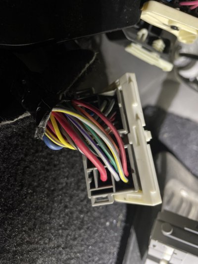

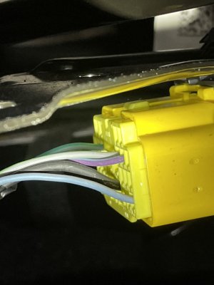

Need a little help here I am trying to read these numbers on the i315 connector but I can’t see the number to PIN number 11 & 14
That the ip2 style connector ... Check your previous email/attachments for the Express seat swap pdf Ben M put together. It's got details on getting the pins into that connector which can be a pain in the x?!
