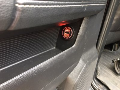

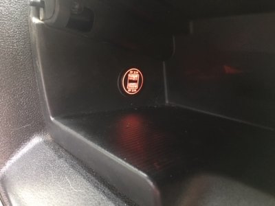

I came up with same idea a couple years ago but Installed them in the recessed area of the door panel so they are kinda hidden but they glow red so easy to find in the dark. I also added on in the glovebox for my extra iphone which just holds all my music to always be plugged in and hidden away.

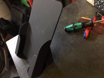

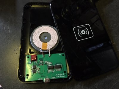

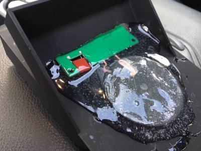

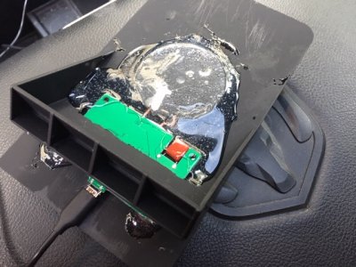

Front doors pretty much the same as back doors. i just didnt need them in the doors up front. I created a ireless charger cradle for my phone in the front console. I took apart a wireless charger and epoxied the coil and electronics to the back of this cradle thats made for dodge rams to fit into the business card slot. Now I just drop my phone into the cradle when I get in.

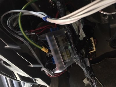

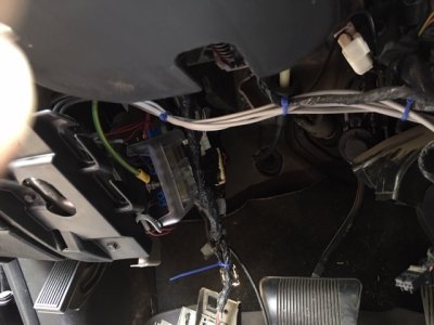

I put a 6 position fuse box with ground lug built in under my front dash. I mounted it to the brace that was under there. I then ran a 8awg power and ground wire to it, the power wire is run to a relay so it will sitch power on and off with the key switch.
I have my HAM radio and all the USB ports run to it. Each USB port is capable of 3 amps
