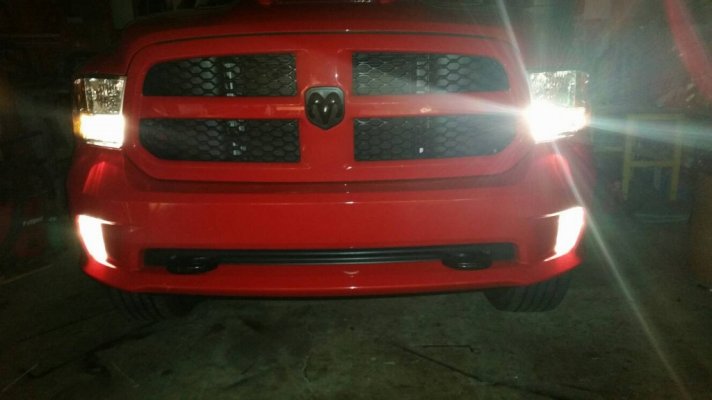

Just did this to my truck tonight! Works great so far. I did the mrtaillight kit in my last truck but it was a waste of money for how simple this really is. Parts cost me less then $25 including heat shrink and tape.
