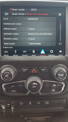

Has anybody found a solution to the dark backup camera screen?
Also, the info for artist and song title does not scroll across the screen on FM or SXM or Blutooth. It cuts off part of the info (usually song title). The RA4 didn't have that issue (at least on FM)
Otherwise, I really like the UAS radio.
Think a software update would be worth a try? I'm running 17.36.39 if I'm looking in the right place

The software info you need to reference is the "application version" which is v18.14 & is the latest anyone has been able to download...
version 19.9 is installed on factory 2018 UAx radios but not available to d/l yet.

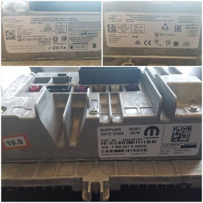

I have one with the 19.9 stickers
M² Mods.
Ohhh, I see. Thanks for straightening me out on that, Mike.

I have pics if needed or can check whatever
Why does it look like the bottom of your screen is being cut off by the bezel? Is it just the angle or is the 2018+ 8.4 a slightly different size the and 2017- 8.4's?
