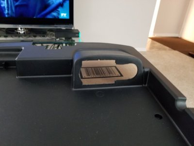

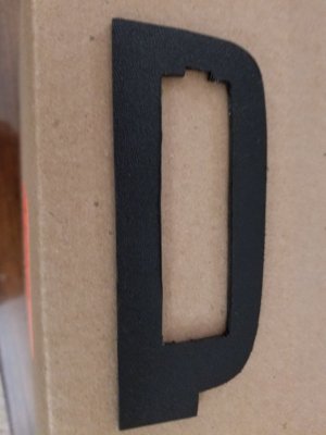

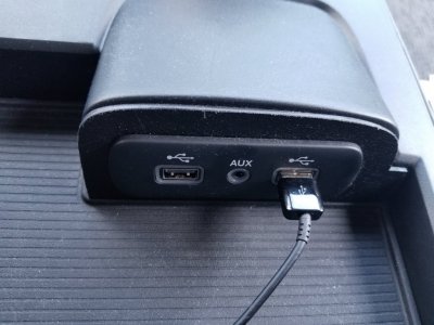

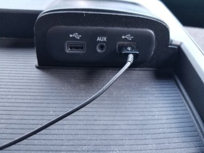

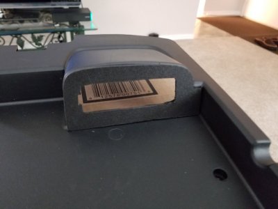

Here's how I solved the media hub fit. Hand formed piece of plastic from an old cassette tape carrying case. The fit could be a bit better but for a first attempt I'm happy with the results! I simply glued the entire package from the backside with GOOP.
