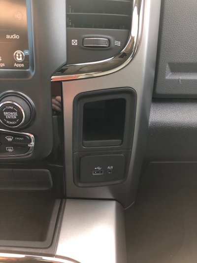

0c5a1eb62e15dc4e66bc9a44ab76028e.jpg. Ok I would like to put in the new 2018 radio in my 2017. Issue I have is I did not have a media console so I put the one I had in the dash. Any idea where I could accommodate the bigger media hub or any way to keep current with new radio?
Did you replace the ac outlet that was there? Also will it work with CarPlay?
Jkieffer
Jun 1, 2017
319
128
I had a little storage compartment and installed an older center console taking out my jump seat. The issue is some of the older consoles did not have a place for the media center so I relocated it to the dash. I am hearing you have to install the new media hub which is physically larger if you upgrade to the Panasonic brand stereo with car play. My current on has nav but no CarPlay which is what I am trying to get. I know their are some pretty smart people on here that could offer ideas short of buying a new truck.
They older USB hub will not work with the 18 radio. You will need one of the 2 USB hubs listed in the OP and likely the 18 Compass hub is your best option as far as fitment. You will also need the UAx USB hub adapter harness that you can get from DeereGuy or myself.
