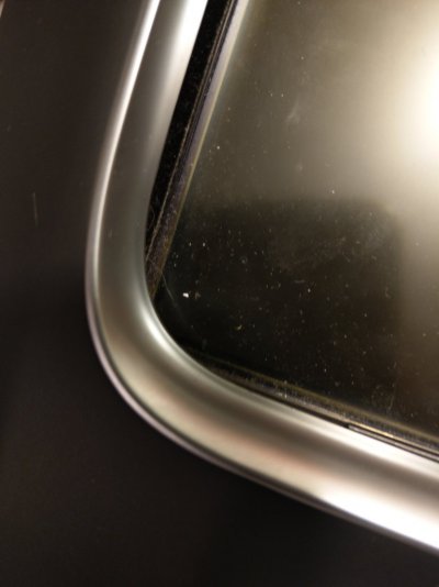

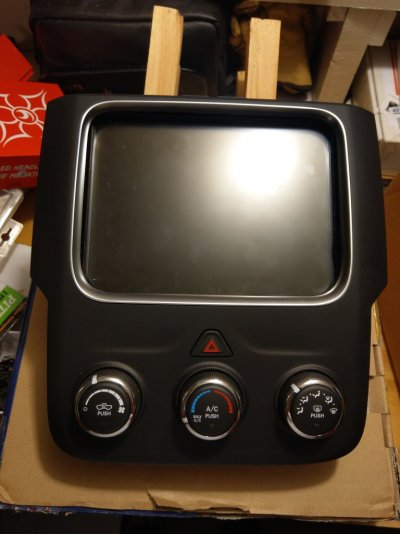

I may be missing this answer but I want to verify something before I waste money on parts. I have a 2018 2500 Tradesman. I want to upgrade to the 8.4 with carplay, but I want to stay with my knobs for the AC. If I order the 8.4 bezel adapter that infotainment makes can I just order a new 8.4 uaq radio and swap it in without any other parts or does using the manual knob style AC cause problems with the new uaq radios? I assume my media hub will be fine.
I know it's been awhile but I just found these pictures I took of the 8.4 in a RA2 bezel. The added bonus of this setup is it gives your passengers less options for messing with the radio ;)
Important to note...
If you don't have at least steering wheel audio controls, this won't give you any sound/audio. ... and the radio won't fully integrate with the HVAC system without the correct 8.4 conversion harness setup & Bezel.
This is an excellent point. I only show the RA2 bezel as a stepping stone to avoid infotainment's inferior (IMO) bezel products when completing this mod.
