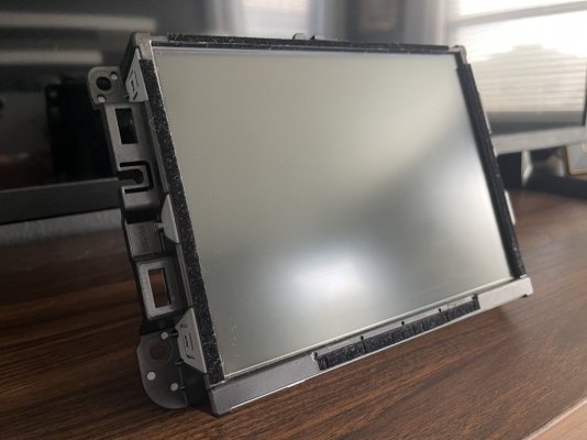

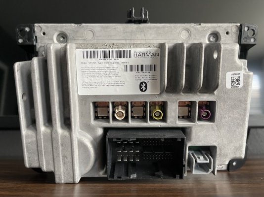

Huge thanks to @Mpgrimm2 for all of his help on this. It’s been a few months but he walked me through every step of upgrading my 2017 RAM w/RA3 to a new unit with Apple Carplay. Couldn’t be happier with my investment and very grateful for the help. If you’re on the fence about this, just do it, you’ll be thankful you did every time you drive your truck.
That being said, I have my stock RA3 and stock hub adapter from my truck for sale if anyone is hunting.
Radio: 68270657AE
Hub: 68096426AD
Best offer gets them.
