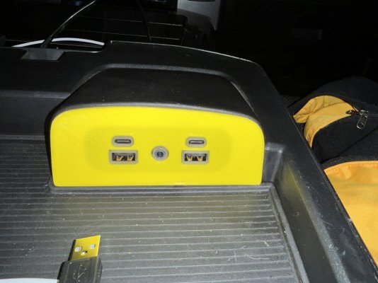

How much would you charge to do it again and can you post a picture of it?
I mean I can print one for you, I assume black is cool. Just pay for shipping. One of the guys in this forum designed it and made it available for anyone on thingiverse. You’ll have to do a little trimming to get it to fit. I’ll find the original post and share it tomorrow. I can also take a picture of how I trimmed mine so it would fit. I made mine yellow, cause I’m a Steelers fan.
Black is fine. Have problem paying you and for shipping
I'd take one as well in Black please if possible.

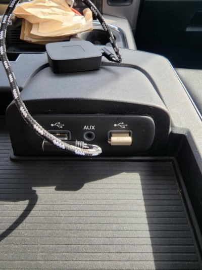

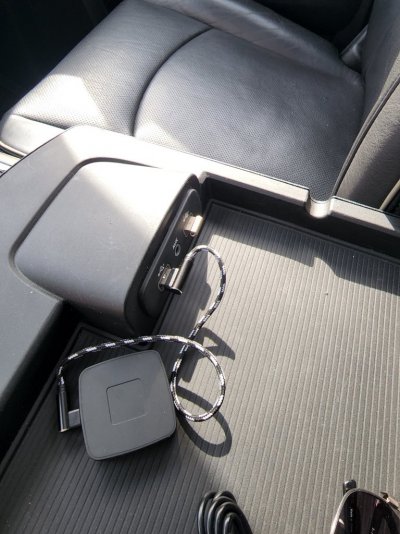

Android Auto (AA) or CarPlay (CP).
I THINK the question related to getting one of the apps working with the hub...or at least which you used.
Sorry I didn’t put that together. I have tested both android auto and Apple CarPlay. Both worked for me fine.
I should elaborate a bit too. When using Apple Carplay, if I plugged in another phone or my airpod pros to charge, it would kick me out of apple carplay. Still trying to figure that piece out. Other than that I haven't had an issue using either AC or AA.

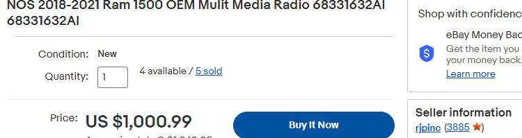

Anyone knows this ebay user? maybe youre here ? all offers declined. Would love to get in touch with the person.
FYI still on the hunt for 68331631, 32, 99 model radio hat would fit my setup. ebay user.png

King of poland.i don't know the seller personally.but the radio I got from him was a brand new ucq.of course it is old stock so it will have a sl o1 screen that has had issues with delaminating.but the radio I got was brand new never installed and in a mopar box.
Much appreciated for info! Are you having any issues with delamination on your setup ?

Haven't had it that long.i have never had any delamination problems with any of my uaqs .I am in alabama it gets humid but rarely gets over 90's in the summer and my truck gets parked in the garage at home so that might help.just use a cloth like you use for eyeglasses and don't use any type solvent or rub to hard.these things scratch way easier than a ra4
