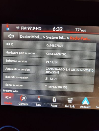

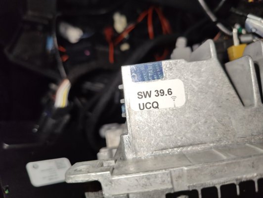

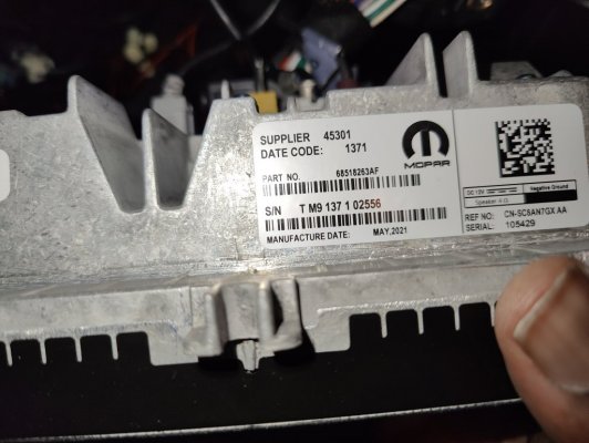

Hello, I recently upgraded to a UAQ unit that I got from Infotainment, and I'm trying to identify what kind of unit they gave me and if I need to update the software. I'm "thinking" its a Canadian unit but the model number doesn't seem to match what I'm looking up here. What do you guys think? Also, I found a sticker indicating SW: 39.6 UCQ, but the radio itself says 21.14.14, I'm confused.

As per Mpgrimm2, The radio software goes by the "application version" . so you are correct on both counts: It's the Canadian version UCQ and 39.6 . In Mpgrimm2 had told me that 39.6 was the most current back in January when I got my unit form a recycler.
chances are infotainment probably buys the UCQ versions cheaper in Cdn funds after the exchange rate. the US buck goes farther up here.

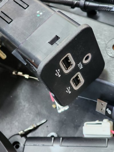

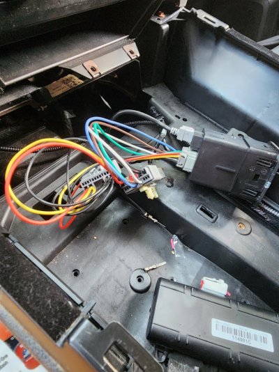

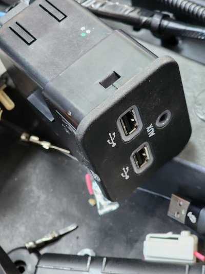

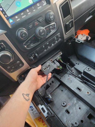

Hey, last time I posted I mentioned creating a secondary USB hub harness with keyed illumination. I just wanted to share that I have completed my first prototype.
I can officially confirm that it all works well! I am waiting on a new hub and a fresh order of connectors for a second prototype. Expect a guide/better pictures soon-ish (connector shipping from china could take a week or 3 months based on my experience lol)
Pictured, my messy prototype harness (will be waaay smaller in V2) a photo of illumination on, a photo of illumination off (v2's hub has bright blue LEDs) and a photo proving it works

very cool. I'm not a fan of the factory hub being in the armrest. a second more easily accessible spot would be very handy.

Found it here. Looks like it is a...
2021 Canadian Jeep Compass UCQ 4c (Nav) radio
PN: 68518263Ax
Panasonic PN: CN-SC6AN7GX
Application version: Canadian v39.6.x

Interesting. Should I be worried that they gave me a unit for a Jeep from Canada? I know it's all the same family more or less, but would I run into any major issues moving forward or should I ask them for a different unit?
