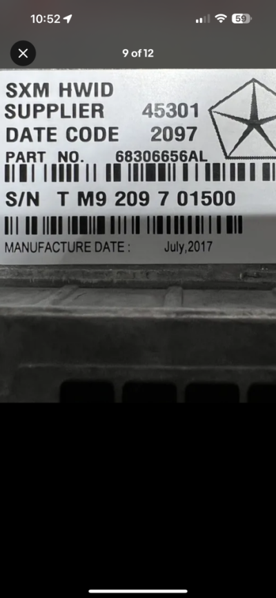

Got a picture of the OEM side sticker with Panasonic Internal model # ? (ie, maybe ... CN-SC2DNxxx )
& What application version?

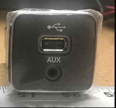

Bron
Oct 21, 2023
Pennsylvania
On the back of this is 2 mini USB ports. what are both of them for. i plugged my factory connector into the bottom one. as the one above it the female connector is backwards. I noticed that my phone drains faster than its able to charge while connected to android auto :( im wondering if i plug the mini usb into the top one if i would get more power out of the USB port? maybe? any info would be great. Everything is working fine!
