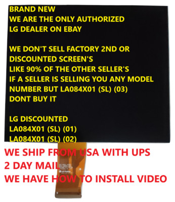

I ordered a new screen off Ebay, reasonably easy to change but geez that glue out of the old screens is sticky - gets everywhere, and hard to clean off you and anything else it gets on. Just have to make sure you get the right SL(03) screen not the older SL(01) or SL(02) ones. Here is an example:
yeah, I did the "clean" on mine last year, and about 3 months later in the Carolina sun, the screen picked up a dead column. Also, the snot is all down the front bezel. Made the trailer controller install much stickier than it should have been... Just had an SL03 screen come in Monday, (Due tomorrow), planning to probably do the rude thing to the truck (again) on Frid.... Well ****, it's supposed to rain the whole next week. I don't like working on the truck in the rain, as the wife has the only car spot in the garage, and we have one of those stupid "split" garage doors that barely let a crossover in, let alone a full size truck.

Just watch that antenna wire attached to the frame when you are pulling it apart, easy to damage it is so small. There is a good youtube video of the screen change process.
I had done it, and when I did the screen last week, something in my head was like "Don't just rip the frame off the radio!" Did the swap, looks way better, but at the same time, the SL(03) screen seems a little "worse" for some reason. Might be it's reflective, and I had gotten used to the "goop-less" screen of the SL(01).
