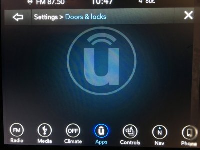

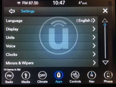

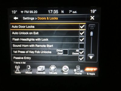

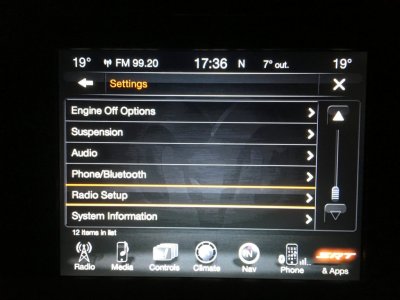

Hi Guys!
I'm following this thread since weeks now, really great pool of information. I did a retrofit here in Germany with a 2013 RAM 1500 Laramie and an EU-unit, because of DAB, the European Version of digital HD radio...
I'm also using the infotainment harness for the heated/vented seat issue and it works fine.
BUT.. I still have some issues I would like to post here. If there already is a solution somewhere in the 585 messages here, I'm sorry. I really tried to read as much as possible to find a way to solve the issues... OK, here we go:
Most issues are in the settings menu, because lot of stuff is missing or empty ("empty" means: item is there, but when clicking on it, there are no options to set in the screen following):
- Settings / Mirrors & Wipers is empty
- Settings / Lights is empty
- Settings / Doors & locks is empty
- Settings / Auto-On-comfort is missing
- Settings / Safety & Driving Assistance is missing
- Settings / Suspension is missing (which really sucks)
I also cannot switch between metric and US units. In the old Harman unit it was under "display", in the Panasonic unit there is a separate setting called "units". But whatever I select (UK/US, metric or custom) it jumps back within a second or two...
Doors & Locks old
Doors & Locks new:
Suspension Menu in old unit
New menu (part of it, on second page also no suspension)
Does anybody have the same / similar problems? Or even better: a solution? ;-)

Hi Guys!
Most issue are in the settings menu, because lot of stuff is missing or empty ("empty" means: item is there, but when clickin on it, there are no options to set in the screen following):
I also cannot switch between metric and US units. In the old Harman unit it way under "display", in the Panasonic unit there is a separate setting called "units". But whatever I select (UK/US, metric or custom) it jumps back within a second or two...
Doors & Locks old
Doors & Locks new:
Regards,
Norbert

How long since you installed it? I'm pretty familiar with this entire thread and this is the first I'm seeing this.
Has it been under 24 hours since the install? If so the truck probably needs to sleep some more.
Otherwise I'm stumped.
The only thing similar that I (and others too) have a problem with is that auto on comfort menu check box won't stay. It's present but when you check the box it unchecks itself.
I'll try to do so. You can speed up the progress a little by sending a reset command to the radio via CAN. Due to the fact that the Panasonic has no Factory Reset, it makes the retrofitting a little bit more difficult. The first time I connected it to my car it did not get ANY setting from the BCM. And every time you disconnect it from power it forgets "something", but not all. Really strange thing.
The check box issue is there for several settings, too, like the switch between km/h and mph. It behaves the same way as you say: it unchecks itself after a second or so...
I'll give it some days in the car an will report again...
