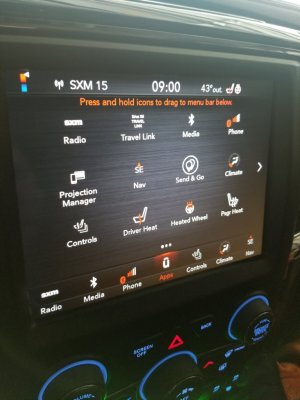

Eeesh . This thing hopefully will learn everything. It thinks I have a dual zone climate, the settings and themes are all jeep. As some prior posts say it won't let me use my heated seats etc, it also doesn't show my cargo cam or back up camera existing. The xm button is available though so I'm hoping it's not done learning. I'm going to let it sit overnight.
Power cycling should make it go quicker. Turn off truck, remove key, open and close drivers door, wait for all dash lights to turn off, give it an extra ten seconds, and then turn it back on.
Do that three or four times...

Unfortunately nothing. I'm just gonna bite my lip and hope she will be fix herself sitting overnight like some have said. As of right now I only have HVAC fan control but no temp change abilities. Speakers in back work but not up front and volume control doesn't work. 1 is the only sound and all the way to 30 is the same as 1 . I do have the infotainment harness installed so after a day or two I'll pull that out of the equation and see what happens assuming I'm still screwed .

Phew. Everything looks good and is operating normally. No surprises just as others reportes no auto on comfort (even with the infotainment harness) , some glitches in the dash cluster with sxm channels sticking and navigation turn by turn in the cluster being garbled. These have all been reported in this thread though. Otherwise everything else works and looks great. Andrioid auto is incredible and feel this was well worth the minor glitches above after swapping my original 8.4N
Looks like my radio does have does have the 21.x update though because my audio is a little muddy. Can't seem to find the version info but the sticker in outside said 21. So be it. Manufacturer date says 8/2018 so it's a relatively new radio
@DeereGuy @Mpgrimm2 couldn't have done it without you both and everyone here.
So far looks like no problems or complications being a Canadian spec with no cell antenna. As others reported I did not need the 911 bypass though I purchased it just in case to have on hand if ever needed since I don't have that hardware.
