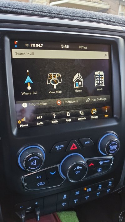

Will someone please tell me how to change the work address on the UAQ? For the life of me I cannot find the answer online or in the head unit itself. 992727acb9ed7ffdffbad39c4aac17ae.jpg

I know it can be done since I set mine 18 mos ago.
I think u have to search the address and then select to 'set as work' or nav the address once and select it from history and set it as work.

I have set my work address I just want to change it but for whatever reason I cannot find that option. I will look again and if I am able to I will post I'm hoping someone that has changed theirs will be able to chime in

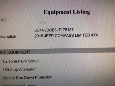

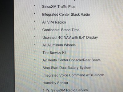

Scratch this I’ve use the Vin number to look them all up and none of them are 4cs except for the one I posted that’s in Michigan
I have verified with the vin that this actually has a 4C in it
Their item number is a 19L025
I would buy it but they don’t do credit card over the phone the only thing they allow for out of town is bank transfers
But if I lived anywhere nearby I would make the drive I think they want like 350 I talk to them the other day
here’s the Vin number of the car that radio came from you can see in the options it says 4 c with nav with navigation
