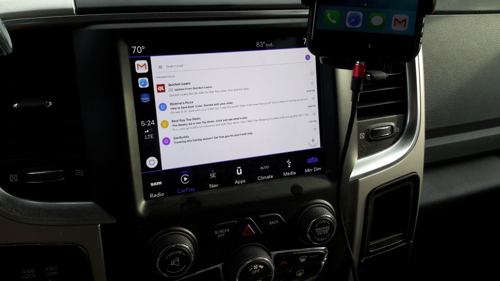

Any iPhone app in Carplay! Trying out a new tweak called Carbridge that allows you use any app on your iPhone in Carplay. Not all apps will look good or function properly especially if they do not follow Apple's guidelines. This tweak requires a jailbroken iPhone. I use Unc0ver https://unc0ver.dev and it works great on my daily iPhone. If you Google and find a site that says they have Carbridge for unjailbroken iPhones it is a scam. Here is the link for the authors site https://carbridgetweak.com
Short video of Gmail and Safari
This thread in Safari
Gmail
Update.
The Carbridge developer has a new companion tweak called Canvas. It allows you to make any image the background for Carbridge. Also, there is a new jailbreak tool out called checkra1n. It runs off a Mac desktop to jailbreak iPhone 5s thru iPhone X, iOS 12.3 and up. https://checkra.in/ Make sure to only use this URL. There are a bunch of fakes popping up. Here is a link on how to use checkra1n. https://www.idownloadblog.com/2019/11/10/how-to-jailbreak-with-the-checkra1n-public-beta/ Some of my friends have a separate iPhone just for the car to run Carbridge.

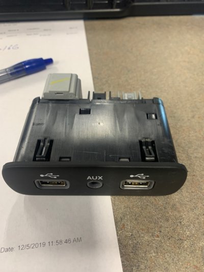

I just purchased 68331635AK from a 2019 classic. They are including the USB hub from the center jumpseat console all for $450 shipped. Is that about what you all have been paying for a UAS?

@SitKneelBend that USB hub is worth $100 just by itself. Dam you did excellent, Congratulations on that deal.
Patience found the radio at the right price and a nice guy on the other end of the phone got the hub included!
Now let's see what comes in the mail...fingers crossed but the build sheet for the truck checked out and he sent me a picture of the right hub (I think).
I've never found one that cheap, or even close to it. They have gotten harder to find as of late too.
