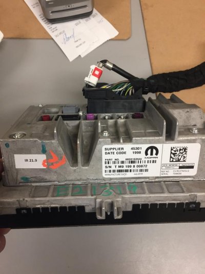

Ok guys some how I ended up with a later model 2019 uaq radio that I thought would work in a 4th gen but the radio and the module came in two separate pieces . Anyone know if there is a way to make this work in my 4th gen ?
Pics?
Sounds like you've got a 5th gen 2019 radio (known working Ram PNs are in the OP to avoid issues) ...
Backup camera definitely won't work, and it doesn't use the same Pinout for the airbag deployment signal notification. There's also a setting I believe is not available to AlfaOBD on 4th gen Ram to tell it the display is seperate from the control unit.
It's probably not impossible, but not likely at the moment.

What about this one ? Doesn’t match your part numbers exactly
The part numbers match, it's just a newer revision from the OP (AH vs AI). Mine is an AK and I believe that is the latest.

Yep, but you can get Pigtail extensions that will work well.
M² Mods.
This is a non nav supposedly so prob don’t need that anyway but antenna I will where can I get the pigtails ?
