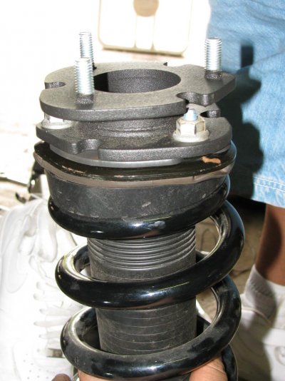

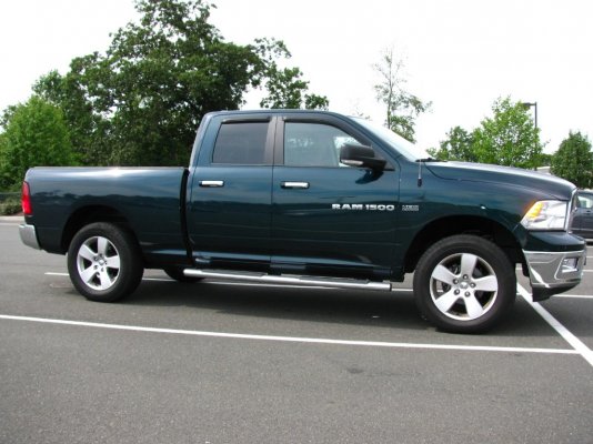

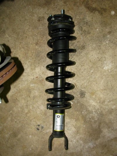

Truck is leveled. I got the 2" HBS kit. I think the 2.5" kit would have been perfect. Here are the pics LOL
Before..
After..

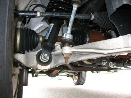

The front axle looks the same as before..
Some misc. shots..
The strut..

Looks good man. One of the best mods you can do.

hell yeah. i can tell there is a difference

well get on it. I did it in 3 hrs. only needed the compressor to get the strut back in its place. 2" longer strut wont go back as easy as it came out.

That's the way they should look IMO. I need to do this. Looks great.

Now you won't drag your nose in the dirt welcome to the next level

It's cheaper and pretty much does the same thing. It's such a small amount it won't hurt the oem struts plus I doubt I'll go any higher than a level.

But I got issues. I got the 4wd wobble thing. Ugh. I used 4wd auto to lessen loss of traction up a hill and it does that wobble thing. I'm wondering if it's in the CV joints. Maybe over extended when I took out the struts? Maybe there are some balls inside the boot not in the right place?
Any 4th genres that did the install them selves? Also the ones that are leveled have you used 4wd yet?
