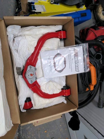

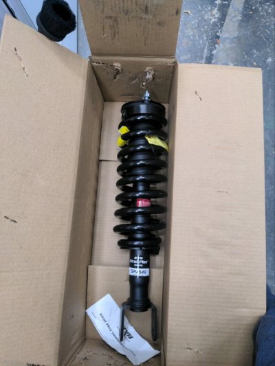

I will be replacing my entire front suspension over the weekend and I will post pictures as i proceed:
Currently 93K miles, everything up front is stock except the new Moog strut assemblies I put in in September and the rough country 2.5" leveling kit. One strut is already leaking so since I have to go back in, might as well do the whole job.
New Components:
Moog cast steel lower control arms
Moog sway bar end links
Moog inner and outer tie rods and new boots
Timken hubs / bearings
Carquest axle shafts, new stub shaft for the drivers side, cant locate a new one for the passenger side
JBA Offroad upper control arms
KYB Truck strut plus strut assemblies
attached are the pictures of all my parts and a before picture of my truck. I don't expect any change in the way the truck looks as the leveling kit is installed, but, with the KYB struts with no leaks, new tie rods and the way improved upper control arms I expect a lot of difference in the ride especially when I go fishing and hunting in some hard to reach places.
Nothing is broken except the leaking shock and my tie rods are a little loose, I just don't want to take everything apart a third time if something breaks after I change the struts, my dad taught me the vakue of preventative maintenance.
