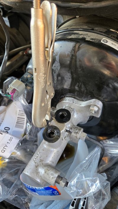

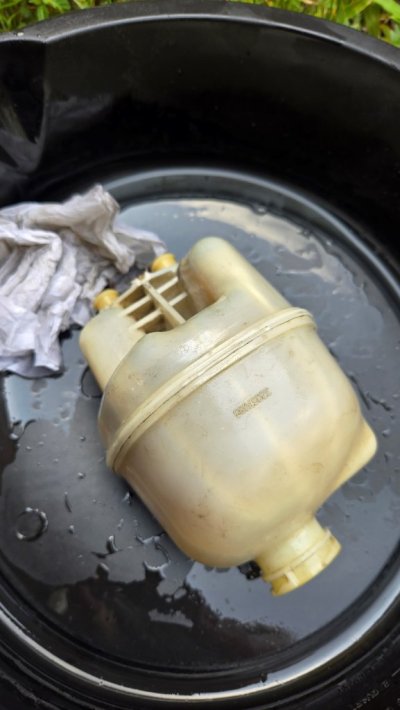

Thanks for the replies. I will wait until the weather cools off a little more and remove the old reservoir by cutting the plastic lugs off. I wouldn't say the gunk was terrible I just didn't want to push it downstream where it could get in an ABS accumulator or whatever it is called. I definitely use anti-seize on steel and aluminum interfaces. Highly doubt the factory does.
QwikKota
QwikKota
Apr 2, 2015
1,528
1,112
5.7L
Lugs came off easily with a hacksaw. The screw was really stuck and required some heat and vice grips. The junkyard (eBay) reservoir's level sensor did not latch properly to the connector and trying to remove the old one from the original reservoir was not fruitful. I will just keep an eye on it, not that critical. Seems like some sort of float that closes the circuit on the sensor when fluid is full.
