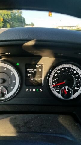

It took the 16.13.13 update with no problem. Did the battery disconnect, still no turn by turn in the EVIC. I'll try a factory reset when I get the 8.4 bezel in. No big deal though. The radio stations do show up in the EVIC , so it might be a Canadian radio thing. I'm pretty happy overall. Going to do remote start and backup camera next. Only thing bugging me is the Homelink module I installed not reading out in the EVIC. Maybe I need CV2 flashed for that to work.

Got the new bezel ,harness, and HVAC module in. Did a factory reset on the radio, now the turn by turn directions show up in the EVIC! Everything works perfectly. I still can't get the homelink to do anything at all, besides the buttons lighting up with the ignition. I can't tell if it is learning my genie remotes. I am thinking about getting a brand new module .
