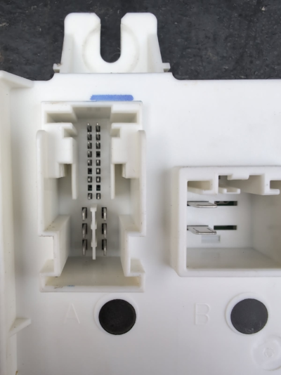

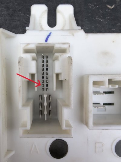

These are the parts needed to fabricate the hvac conversion harness.
1 HVAC CONTROL MALE https://www.digikey.com/en/products/detail/molex/0307001081/3044523
8 PINS https://www.digikey.com/en/products/detail/te-connectivity-amp-connectors/1393366-1/2700940
1 HVAC CONTROL MODULE MALE https://www.digikey.com/en/products/detail/te-connectivity-amp-connectors/1318917-1/2273522
24 pins https://www.digikey.com/en/products/detail/te-connectivity-amp-connectors/1123343-2/2054072
1 HVAC CONTROL MODULE FEMALE https://www.digikey.com/en/products/detail/te-connectivity-amp-connectors/1376103-1/2273523
24PINS https://www.digikey.com/en/products/detail/te-connectivity-amp-connectors/1376109-1/2331294

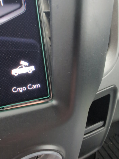

I've yet to dig into the wiring specifics. Got sidetracked on using the cargo cam input as a front cam LOL
EDIT: I'm 100% sure of the fitment of the 8 pin connectors. 99.5% sure for the HVAC module. I pulled the PN off of my connector and cross referenced so I am fairly certain it is correct, but until someone gets it in their hand and actually plugs it in, I can't say 100% - also there is an extra connector on the harness that I believe is for the 4 position blower, which doesn't really apply here)
That all looks right but I'm using the 8.4" conversion harness from @Mpgrimm2 so I didn't actually purchase any of those parts myself. In addition @Jimmy07 posted up the wiring diagrams for the UAV/UAX screen which can be found here...

Perfect. Could probably even get the cargo camera to trigger on the bed light button. Ideas in motion.

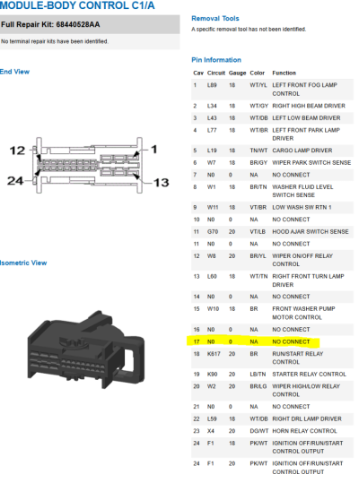

Likely a BCM from a newer truck? what am i looking for here? - Definitely, the BCM from a 2014 does not contain the logic/line for the Disassociated display as that appears to have first been introduced in 2016. I got a 2016 BCM for ~$75 on eBay. One thing I'm unsure off is if there are any differences in BCM for the Eco Diesel. I would confirm this before purchasing a BCM and if you decide to go this route I'll give you some tips before doing the swap so you don't have to wrestle with the things I did (I'm thinking of starting another thread with my experience as you'll run into a few weird things that "kinda" mostly resolve on their own). The only difference I noticed physically from my 2014 BCM and the 2016 BCM I installed was the addition of one PIN to the 2016 (but wiring diagrams for both says this PIN is not used.

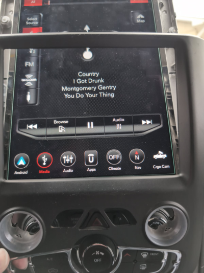

I'm doing this with the 4C but the Uconnect 5 should work too. theRamguy over on the 5th gen forums has collated A LOT of this data and placed it on a google drive he has shared. Here is the link (lots of word docs and part numbers).
Feel free to ask more questions here though, I think I have my head wrapped around pretty much everything and have read over 300 pages on the subject from the forums. As for Infotainment, their OBD Genie is nothing special and you can do everything it does using AlfaOBD to program the radio and BCM. Theirs is simply an OBD device that once plugged in runs the commands itself. If the changes aren't captured in docs from that G-Drive above, then it shouldn't be hard to figure out the changes and program them with AlfaOBD. I have a Pacifica with a UConnect 5 we can compare settings with too and a Jeep Grand Cherokee loaner I'm going to pull the config from before giving it back to the dealership.
View attachment 561103View attachment 561105View attachment 561106

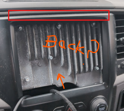

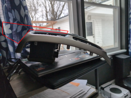

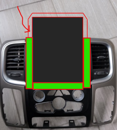

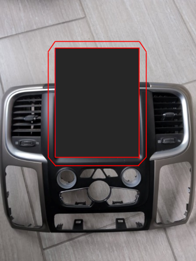

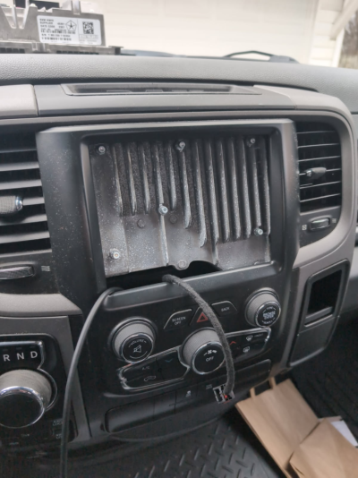

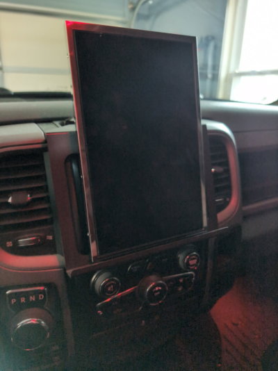

Here is generally what I'm picturing as the footprint of the new 12.1" screen mount. It will attach using only the two screws under the rubber mat on top of the dash.
View attachment 561331View attachment 561332
Okay, yes, this is what I was thinking. Do you have the measurements from side to side, including the outside edges of the bezel? Also, what’s the thickness of the bezel width wise?
I was considering mounting it behind the existing bezel, then cutting part of the top bezel and the sunglass holder to slot it in, so it’s slightly recessed. After that, I could 3D print a cover and a fan for the top section and board. I think that would make it look more factory.
Can you mock up a crude picture of what you're thinking? Just trying to visualize it...
Crude but works lol basicly the green sections would be BEHIND the stock bezel instead of on the outside this would need cutting a section of the sunglass holder or the trim of it thats on the faceplate i belive looking at the pictures out in order for the screen to sit further back in the dash and I dont have a screen so just judging on this lol.
Also another thought do we need to upgrade the USB port in the console for this to work as well to something like this:

would have to cut out the section in red and looks like the radio unit might be a bit to close to reses it may need to have that go back about 1/4 of a inch if possible? but with a pice of eva foam on it may actually give us a good molunting option.
Got it, I see no reason why that would not work, my only concern (in my current setup) is that the radio screen would be tensioned on the back of the radio module metal to metal. I used A LOT of foam to stop the screen from rattling in my current ghetto setup but the screen weight will be greatly reduced (probably 60%+) when the aluminum frame is removed and a 3D printed bezel used.
That being said, I only mounted the radio module there because I'm out of room behind the radio (I have a lot going on back there). You could easily mount the radio module somewhere else and use longer cables to reach the screen inputs which would leave nothing but air where/how you want to mount it. I'll see if I can snap a picture of a spare bezel in front of the screen so you can see how it will look like that (kinda). If I remember correctly, you'll see just a little of the metal frame on the screen itself from the dimensions of the 8.4" bezel.
Here are the pics (that's the bezel I'm sending you too, it has scuffs on the part you want to cut out so it's a good candidate for the finished product too). Sorry about the angles, it's a hard picture to get and protrusions on the back of the bezel prevent it from sitting flush without modifiction.
