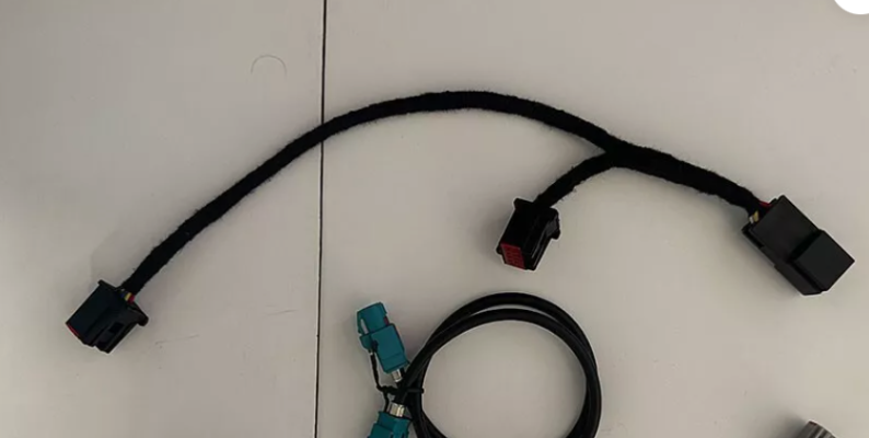

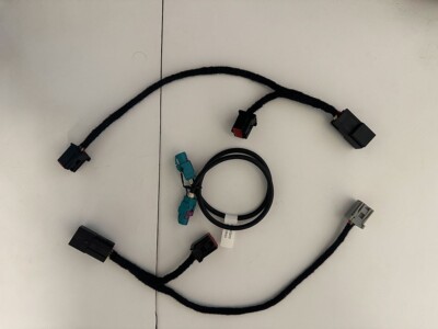

68082364AC Is the lvds cable .
You need to make a small conversion harness for the new display screen which will allow you to plug your existing 8 way connector into it .

Also, it looks like this kit will do the trick and allow me to plug in both the screen and HVAC module simultaneously although I don't think I've come across that in all the threads you guys posted on the upgrade in a 4th Gen (having both plugged in with a y cable)

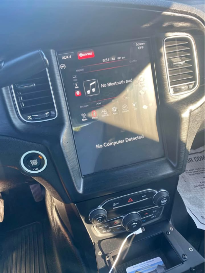

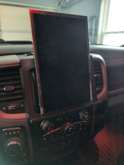

Just another picture of my latest idea. The 12.1" has a chrome bezel all the way around it and the actual screen size appears to be nearly identical in width to the 8.4". My current idea is to utilize the 8.4" single zone bezel and volume control and cut away the top of an 8.4" bezel to slide the UAX screen behind it, then cap it with a 3D printed cover to enclose the circuit board and connecters near the top of the screen.
I just have it resting on a tablet mount to simulate the actual installed height but the screen itself would be about 3 inches back but at this same angle.

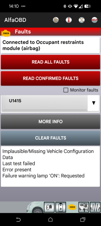

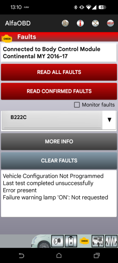

Here are the relevant codes (I think I successfully got rid of the B222C in the BCM though

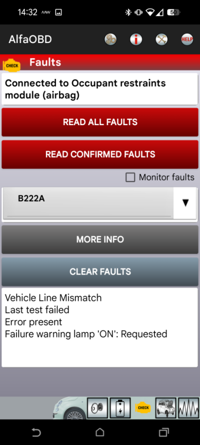

And here is what is popping in the Occupant Restraint Module...

So, if this error is literal and it is referencing the "vehicle line" of the BCM Config, I've found the problem but have no way of fixing it (I think)... "DS - RAM 1500" is the setting for 2016 BCMs and "DS" is the setting in the 2014 BCM.
