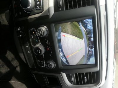

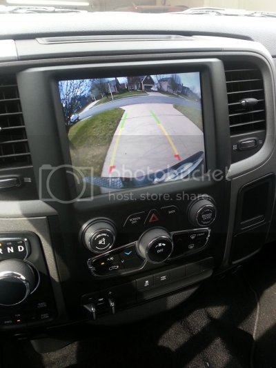

In and done. BCM wire was a tad hard to get to but not too bad. I used the small nipple below the bulkhead fitting on the drivers side firewall to pass the wires through. I used a small piece of wire to pull the harness with the aid of some WD40 on the harness wrap. Pulled through like a charm.20160313_161405.jpg

Nice job looks good. I plan on tackling this in a couple months.

Looks good , glad to see you got it done !
I see your profile says " mechanic "
Now that your done , on a scale of 1 - 10 what would you Sir rate this OEM Kit install difficulty wise ?

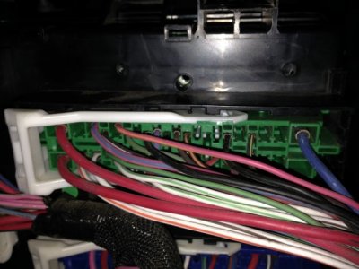

So from the photos posted for the PDC, my wiring looks completely different. I don't have anything at the spot shown in the other pictures, my pk/yo wire is several spots to the left. 13' 2500 tradesman.
So where do I connect to?
I also finally got my BCM connector disassembled, to find that slot 45 does not have any wire connected to it.
So would I just connect straight into these two slots with the wires from the kit rather than splicing into anything? And where can I get the connections for the end of the wires (internet only or any suggestion on auto parts store, etc.)

Hopefully one of the guys that did the full install will comment, but
- if you are ABSOLUTELY certain the BCM C5/E pin 45 wire (Lin Bus CBC3) is not populated then I believe the directions tell you to install the pre-crimped pin/wire in the cavity.
Check & recheck first! (no one else has had this happen yet. Doesn't mean it isn't possible)
- Same goes for the PDC wire. Recheck! No one that has done the full install has reported not having the 12v wire already populated.
Edit: comparing your PDC picture to RLK's (post 290), I don't see the PK/yl wire populated at C7-13 either. Don't see a few others also. But sure if there is a pin already crimped on the end of the new wire, but if you are sure of the pin location, you may be able to just install it in the connector.
(You will need to be able to disassemble/release both connector's TPA locks before you can insert the pins)
Mine is a 1500 , not sure if any different?
Are you installing the oem kit ?
What two slots are you talking about ?
I've read sometimes the wire colors do not match the installation instructions.
@ the BCM C -5 connector socket # 45 if there's no wire there just insert the purple wire from the kit there ( mine had the pin pre-installed )
As far as the PDC , your wire may be a diff color , suggestion , with an ohm meter locate the Parkview 10 amp fuse socket (yours may be empty) anyway verify continuity from the fuse socket and the bottom side to verify the proper color wire to splice into for your truck .
Hope this helps
