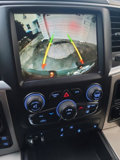

Just wanted to post some info about the backup camera install on my 2015 Ram 1500 Big Horn. Truck originally came with the RA3 radio and no navigation or backup camera. I bought a used OEM RA4 radio with nav and OEM tailgate handle with camera and jumper harness off fleabay. Also purchased the needed harnesses from Mike Grimm. My truck was an oddball and had the i220 style connector under the front driver's seat. Mike's harnesses were perfect length and looked damn near factory. Follow the instructions when it comes to removing connector lock plates and what not. Getting the pins in correctly can be a royal PITA. Almost everybody on the forums uses AlfaOBD to enable the camera, but I used JScan since I already had a vin license purchased. Jscan also allowed me to change the VIN on the used radio I installed.
Highly recommend going with an OEM tailgate camera and handle along with Grimm's harness. Nothing beats factory parts and everything working like it came that way from the factory.
