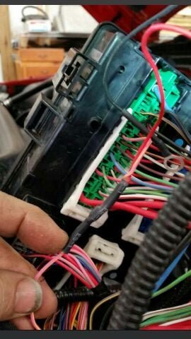

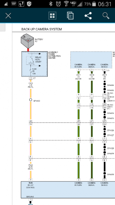

Make sure with a meter the fuse #95 as shown here .
At the PDC is in fact the wire you spiced into .
This is mine , the red wire from the kit solder spliced into the factory pink & yellow pwr wire from the fuse #95

It's the 10 amp #95 fuse labeled Parkview on the pcd lid if I remember correctly.
You'll have to Un latch the PDC , turn it upside down and verify with a multimeter from the top side with the fuse removed , to the bottom side for continuity to be 100% correct ...this is what I do .
