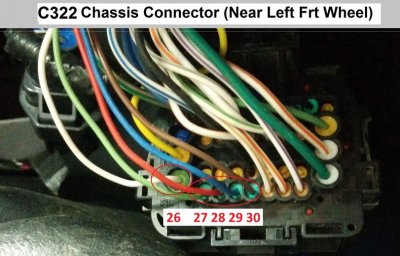

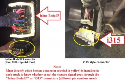

POST Pictures of what you have showing where the wires are missing in the connector cavities please. Yours should look similar to mine.
You will need to confirm whether or not you have the i315 (pins 18,19,20 on most 1500's) or INline-Body/IP connector (pins 17,18,19 on some 2500's) down by the brake pedal. Once you do, I recommend you ohm out the appropriate 3 camera wires from that connector back to the i550 tailgate connector (pins 1,4,5) to be sure. I'd hate for you to waste your time and money.
See attached.
  • 76474d1472557729-installing_oem_backup_cam-dannymk2_inline_c1_cam_connectors.jpg

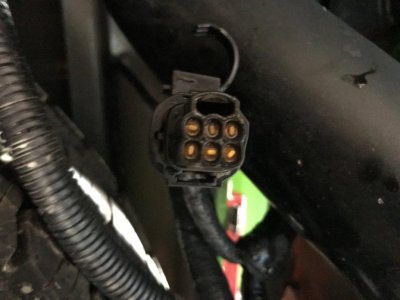

The 4th picture is the chassis connector. How can I figure out what I have there? It doesn't open easily. Unless I can't figure it out.
Connector right side missing the 3 wires
Connector left side has 3 wires in those positions
crazykid1994
Sep 21, 2013
5,063
5,064
Florida
Got it open... pain in the butt
Looks like a different connector than yours. Almost might have to go to the dealer because my handle for the tailgate doesn't have the same screw locations for the 16 cameras I'm seeing on eBay or other sites. Screws line up 90^ instead of the 180 that I saw online. will post radio connector when I go to swap to the 5.0.

Crazykid,
Not sure where that 4th connector is that you are showing, but yeah it's not the same. Is it behind the left front wheel's plastic liner by the driver's floor board?
From what I see there so far, you are missing the chassis and cab wiring for the backup camera. Which means that piecing it together is not a cost effective option unless you scavenge all the tailgate parts for cheap.
You are likely better off getting the full Mopar kit with all the wiring and camera parts.

Behind front driver tire attached to the truck frame. I traced it forward from the tailgate. It is under the driver door.
Look up behind the left front wheel's skirting, b/w the wheel and the body
