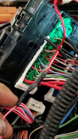

Fwiw here's a pic of mine when I spliced into the red wire from the kit with the pink & yellow.
Hope this helps !

Saw those pics and was expecting a pk/yl on slot 13. Imagine my surprise when I had nada. The question remains, though. Is this a hot on key constant or is it supposed to switch with the trans going to reverse?

Hot on constant with fob in run position .
