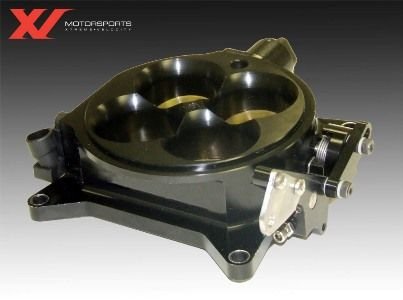

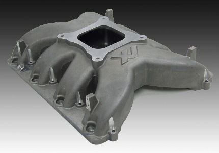

Ok guys, I got too much time on my hands. Give me your thoughts about this setup. This would obviously work best on a stroker motor, but might provide some gains on a slightly worked motor as well. I especially like the manifold on a boost engine as the manifold is being pressurized and you could easily do a little maching and turn this into one hell of a nitrious rig with port injection.
My initial thought is to use a ported TB and bolt it to an adapter plate and mount it pointing up. This would be straight foreward and no doubt would work. A second thought is to modify a billet TB using the FBW assembly off of a old OEM TB. There is plenty of aftermarket 4 barrel TB's, but they are setup to run on GM's or cable. Hell, maybe use the TB off of a Viper if it is FBW. Anyway just having a couple cool ones and thinking out loud.

They also have a manifold for the 6.1 head which I really would like to have with the resized chambers to pump the CR up to 10.25 on a stock 5.7 block. There are some very cool pieces out there to play with.

Doesnt that manifold net 0 gains because it bumps the powerband up to high in the rpm range to actually use the added flow? I'll have to go do some digging through old threads on a different site but there were dyno sheets showing that on the hemi trucks they actually lost power because of the powerband moving to high in the rpm range to get any use out of it. And with the stock heads I would think it be pretty much useless at any rate because it wouldn't matter how much flow was going to them as they can only handle so much with the stock port size. Let me see if I can find a link to the dyno sheets, may have to do it at lunch today.

From the sounds of it, the truck manifold is still the better of the bunch, the 6.1 manifold is better after the 6000rpm mark and the xv manifold is way up there in a range our trucks will never see.

Exactly, unless its strictly a track vehicle, and you are turning in the 7( area there is no point of doing this intake manifold since you wont see any gains under normal driving and may end up loosing power in the end.

what is there to tell. Simple fact is that it is useless in the lower "normal" operating rpm range, dyno sheets prove that. In order to get any use or added power you need to be spinning it way up there in the rpm range.

We know trucks are built for torque, so it's not surprising to see the ram manifold as a digger. LX manifolds for lighter wieght and more mid range. I think the big draw for this manifold is that it's metal and it can be machined and and welded on. Just looking at it you can tell it'll flow big time and I am thinking the design is a bit more suited for a carburetor, but I still like it. Maybe it can have some work done on it to increase the runner speed a little. I'm planning on tuning my engine for the 6k-6400 rpm shift range so I'll want it to still be pulling strong pass 6k. Anyway I hate to discount anything out of hand just because it may not be the flavor of the day. Beside's anyone thinks a 345 ci engine is all played out at something under 6k has never owned a sm block chevy. We will see.....

I'm with you on it looking good for a wet setup with nitrous port injection. There is a manual 4bl TB that flows 750 cfm that looks good. Like I said before, maybe use a DBW TB bolted on top pointing straight up or grafting a old OEM TPS/IAC to a bracket on the side of a manual 4bl TB. And of course perfect for any forced induction system. How about machining the top off of it to mount a intercooler and whippler?
