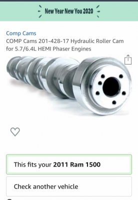

Would this cam work as well as it has Phaser Engines?View attachment 193594
Link doesn't work,i just see a pic,nothing else.I'd personally go with somebody who does a whole cam kit,that way,you're getting matched components,mickey mousing a cam package together,has a good chance of coming back to haunt you,and costing you more money in the long run,ask Tuned Laramie about his 6.4 cam swap,if you haven't followed his head-ache thread,lol
