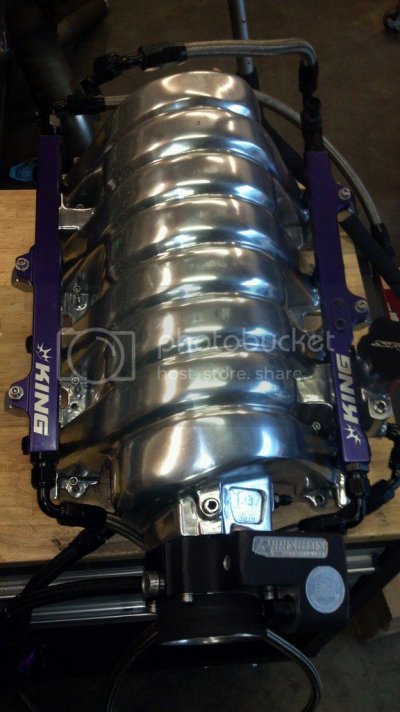

Yep Matt has ya pointed in the right direction. For that size your gonna wanna be boosted and even then the truck maifold wouldnt show the best gains. To give you an idea this is a built Indy intake with built fuel rails injector setup with an Arrington 90 mm tb that is on out 426 stroker 88mm turbo SRT Jeep and it flows correct for all that extra displacement and boost.
