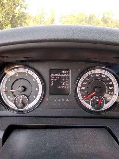

My 2017 HEMI has a lot of idle time and idles ~ 600 rpm, however at hot idle the oil psi is ~ 48-49 so maybe that's the reason it hasn't imploded? ... or maybe it doesn't have enough miles on it yet? ... or maybe I got a good one? ...I don't know.
I don't really put to much in stock with what the trucks "internal smartness" displays. I'm going to keep up the oci's and keep the tank full and hopefully it'll keep on hamm'rn on down the road.
